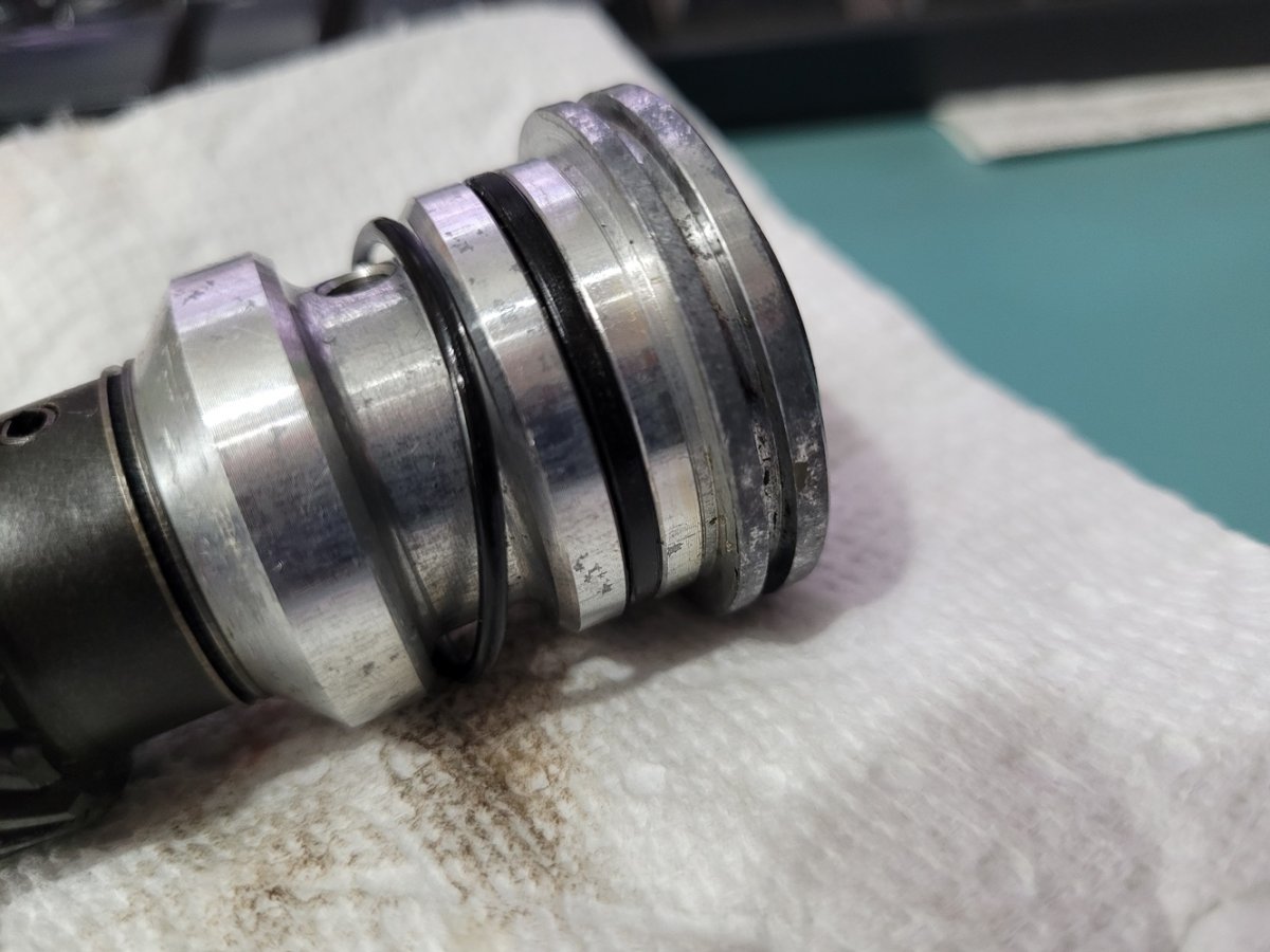

On the oil pump drive. The seal on mine seems to be more of a square molded piece of plastic, like a bushing. It does not fit snug in the block, very loose and surely will leak. Maybe it's just a hardened oring.
I got a FelPro 74061 distributor mounting oring for Ford V6 which lists applications 4.0 OHV VIN X 1991-1995, as well as 3.0 1991-1998 and 3.8 1990-1995. This oring seems smalled thickness than what's in there now, unless it is intended to sit at the very top under the flange where there is a small groove, though the oring doesn't sit down it it nicely since it's a very shallow groove.
Am I supposed to remove and replace the existing part that seems thicker? Or Slide this smaller oring to the top and let the hold down keep it sealed to the block? Or do I need a different oring to replace the hardened part?

That is a hardened O ring, remove it and replace it with your new one.
Lube it up with vaseline when you install it... often I have to give the top of that a soft tap with a mallet to get it seated.
Thanks. New oring looked slight thinner but definitely squeezed in a bit and is sealing.
