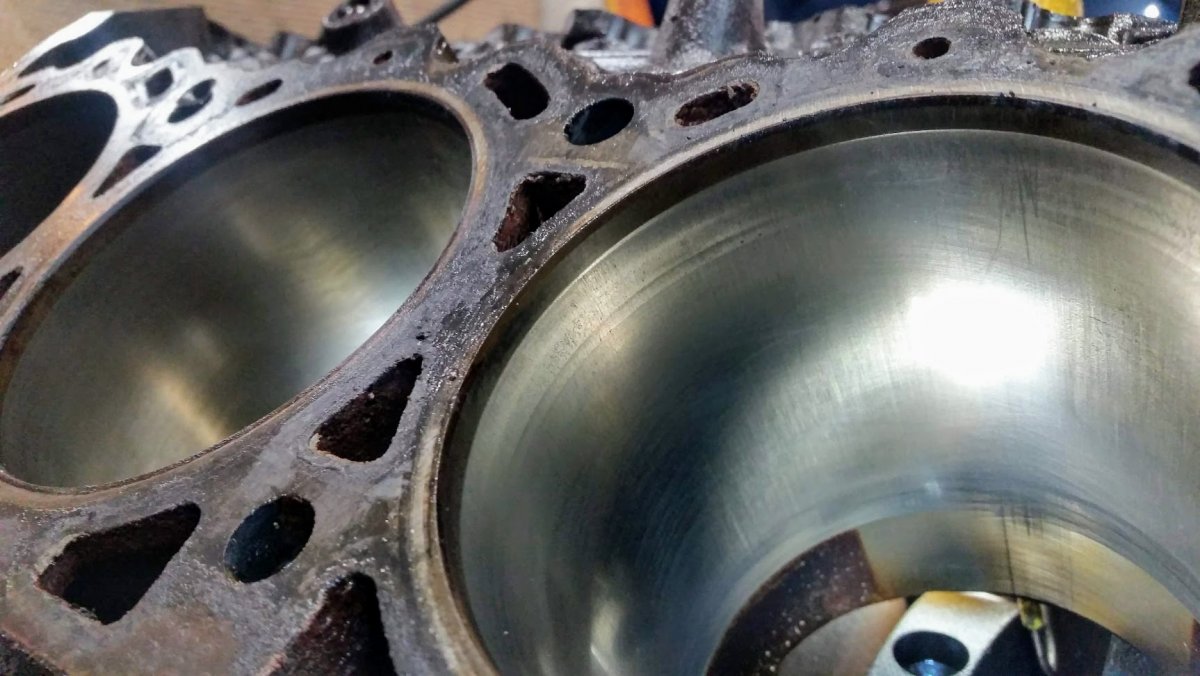

Exhibit A:
56810
Cylinder 1, no compression due to exhaust valve roasted .120" up into the head.
The dark ring above the fire ring isn't catchable with a finger nail, and reads about .001" with a bore guage.

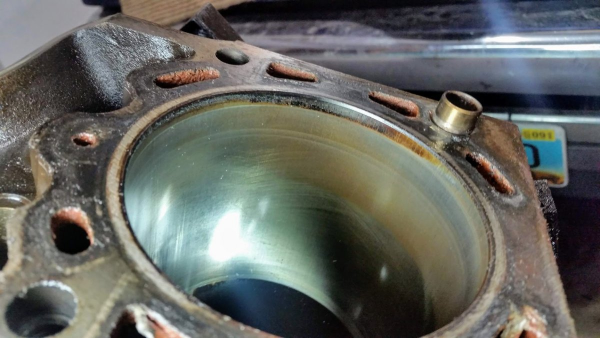

Exhibit B:
56811
Cylinder 6, 125 psi compression before disassembly.
Oil soaked plug boot was arcing to the manifold causing a misfire and excess carbon deposits in the chamber and above the fire ring.
