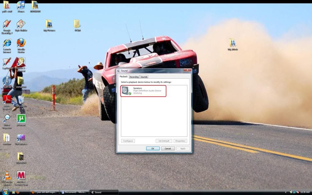

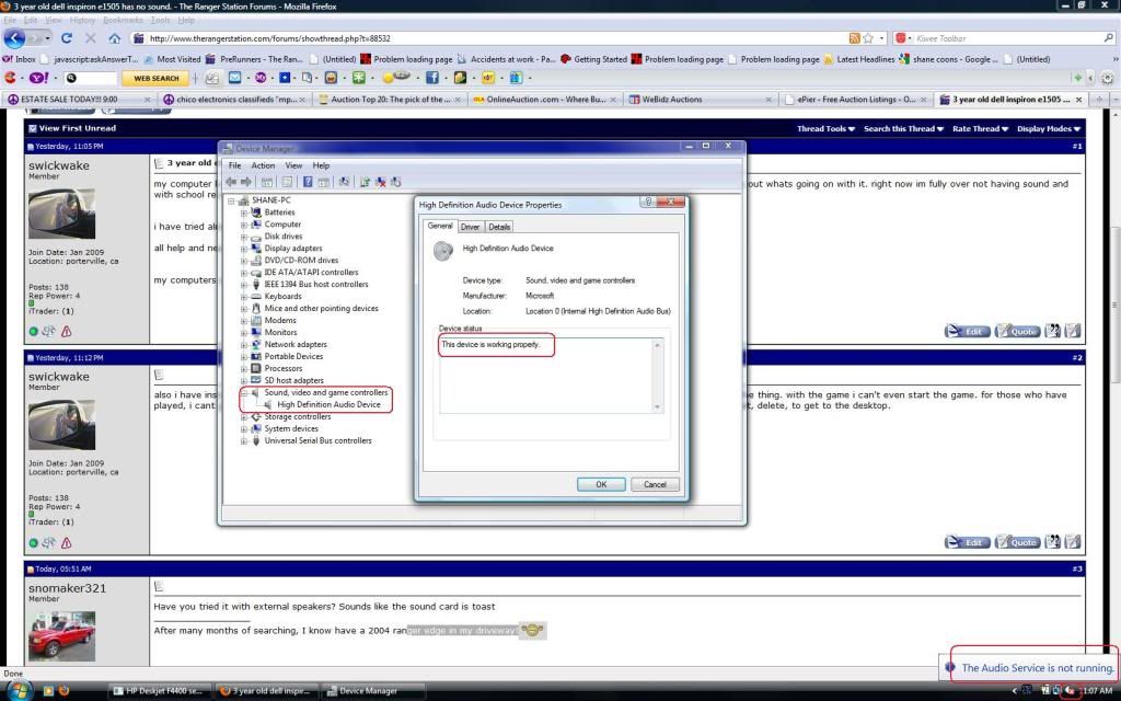

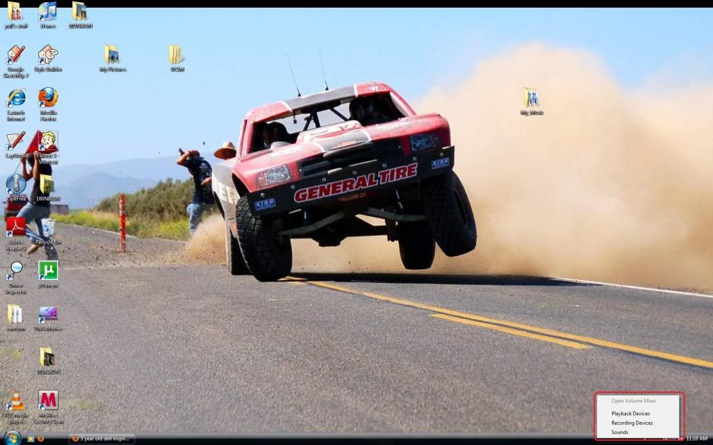

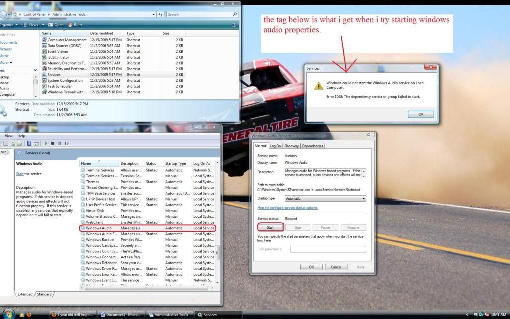

these are some screen shots of my pc. hope these can help. i can take other screen shots if needed.
i will re-download the drivers given.
look for the red squares
let me know what you all think.

It looks like C:\windows\system32\audiosrv.dll could be an issue. Some people on the internet are saying that they take the dll file from a working computer and paste it on their and it starts working. I would check to see if it is there atleast. You might try an sfc /scannow to see if it helps.
i really think you guys for the help out but as of now non of the drivers worked. i really do not want to re install everything just yet. i will try finding a good .dll file.
where can i find this file and how what will i need to copy.? could i please get a screen shot? what is this sfc /scannow?
