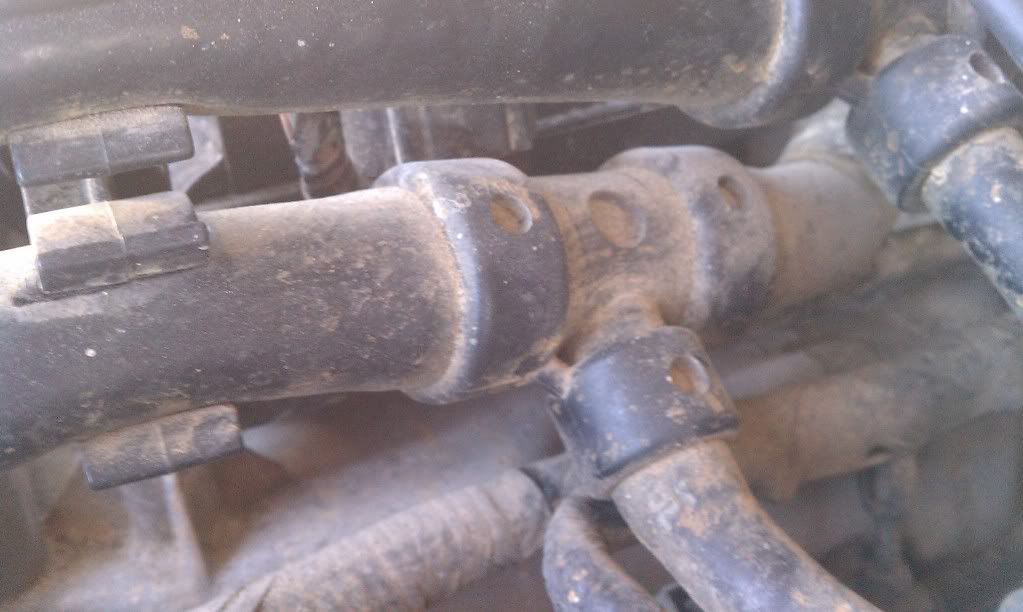

Think I found the source of my decompression sound. One of my a/c lines is leaking down onto my number 3 cylinder plug wire, possible problem?
Also noticed my coolant overflow tank is 3/4 full even when cold, it wasnt like this before my problem-thermostat maybe? Went ahead and cleaned my MAF no difference noticed.
:icon_confused: You mean your air conditioning refrigerant is leaking onto the plug wire???
Are you loosing fluid or not? Do you have white thick smoke out the tailpipe on cold start up?

Truck not losing coolant or running hot just think its strange that before the problem coolant only just lined the bottom of the overflow tank and now its nearly full all the time
As for the a/c line it runs over my valve cover and into the cab its leaking down and dripping over the valve cover and down onto the number 3 wire.
I've never seen an A/C line run "over" a valve cover. Do you mean it's dripping water onto the #3?
