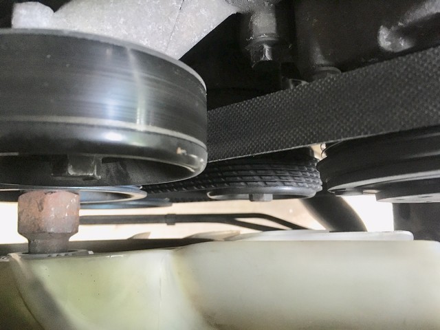

My 2000 3.0 Ranger has had a mystery noise for a while:
http://www.youtube.com/watch?v=_-cekrjAcPc
Finally cured it with a new tensioner. You can see in the pictured how the belt was riding towards the front of the pulley on the worn out tensioner making it squeal as it was going onto the crank pulley. The belt being out of alignment was rubbing the sides of the ribs. The temperature of the belt and pulleys would make the noise come and go.

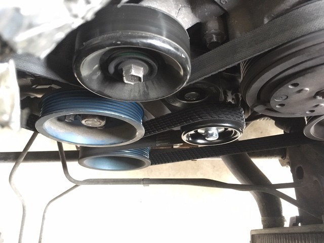

Here is the video of the new tensioner installed and running properly:

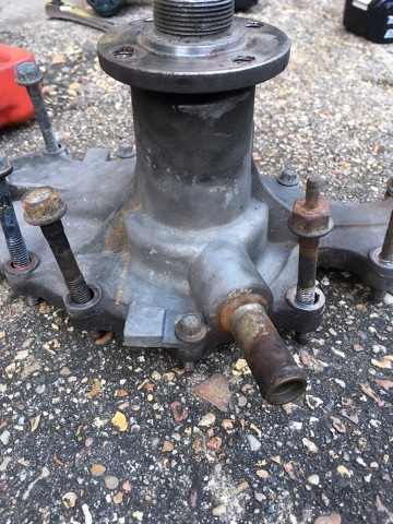

Well, I spoke too soon. After running for a while, there is definitely a noise from the water pump bearings also. Just ordered a Motorcraft pump from Rock Auto.
When I had the belt off to do the tensioner, I though the water pump spun a little too easily like a bearing was dry. It isn’t leaking so I’m going to keep driving it until the pump gets here.
One new water pump installed. The part that took the longest was getting the gasket off the timing cover.

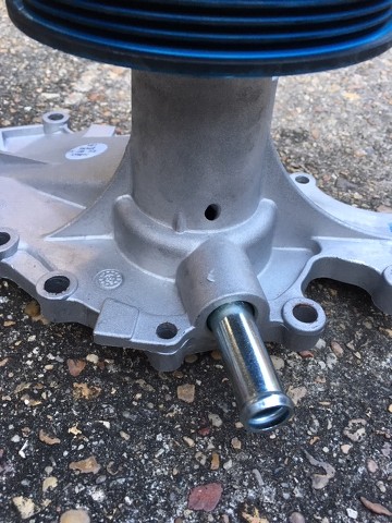

I bought a Motorcraft water pump from rock auto. The impeller is fully enclosed compared the other brands available. But one thing on it that looked different is that the weep hole between the bearings is on the top of the pump compared to the one I replaced which was aftermarket.:
This just seems like it is asking for grime/oil/general trash to get in there. Luckily, my job keeps me well stocked in ear plugs, so I made a plug for it that should also let any pressure out if the shaft seal fails:
The old pump's bearing were really dry, so it was just a matter of time......
