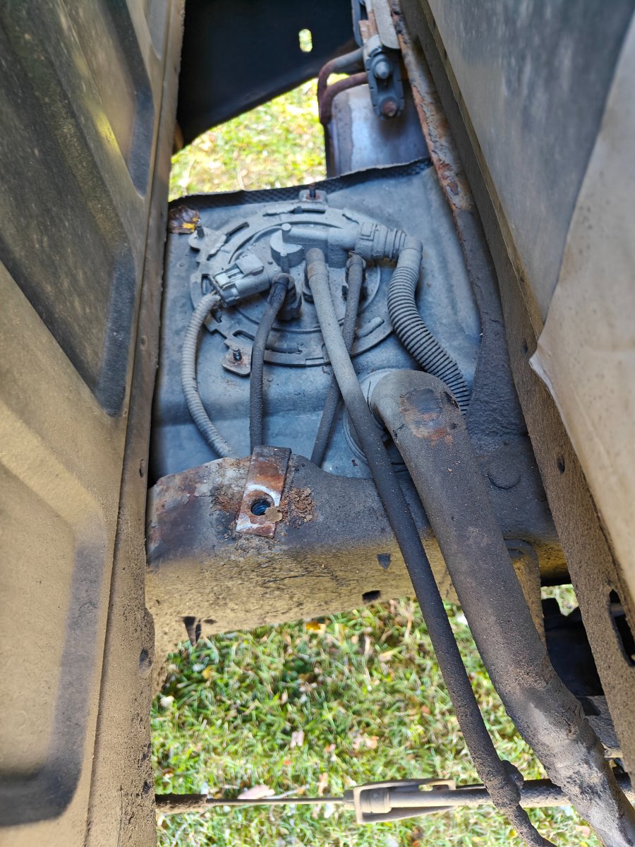

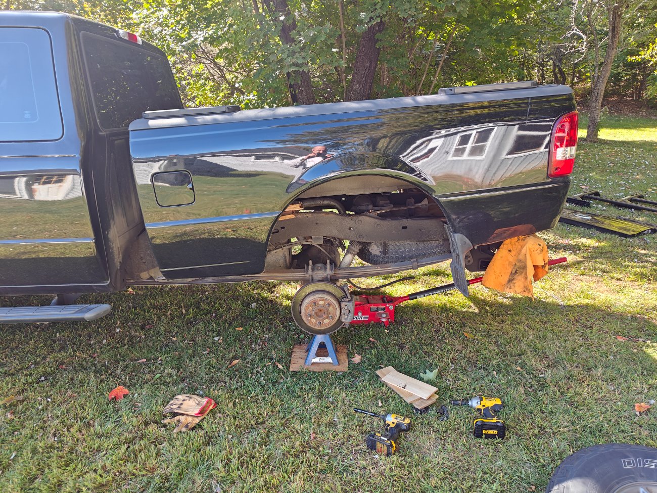

Here is how I moved the bed back to change my pump without removing the bed entirely.
Hey Sandman, I may be a little late but I have a good used OEM fuel pump if you want it for parts or to use whole. I swapped it when I was trying to fix my fuel pump but come to find out the fuel pump wasn't my issue.
Here is how I moved the bed back to change my pump without removing the bed entirely.View attachment 136575View attachment 136576
