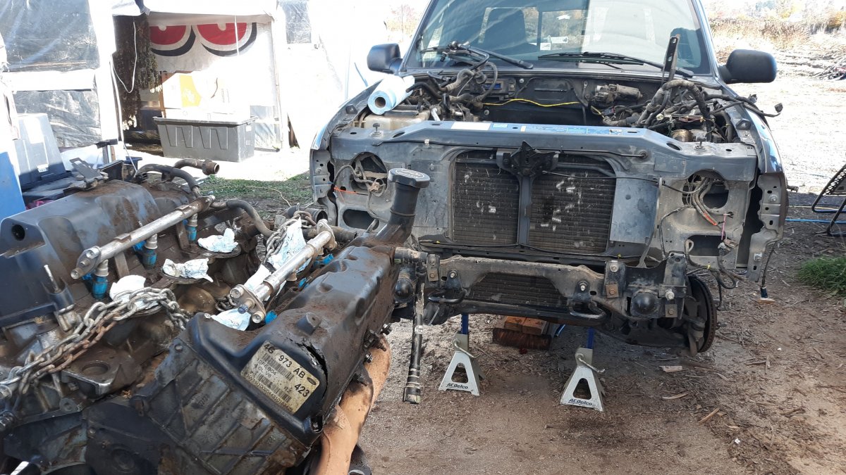

Yes, mine was at 200,000 when I purchased it. On some bad advice from a buddy and my lack of experience rebuilding motors I regretfully chose not to do a thorough inspection the first time I pulled the motor. Thought it was too complicated and that I might get away with addressing the obvious issues. However, would have saved both time and money by removing the cylinder heads and having the block checked by a competent machinist. The machine shop I used did a valve job, repaired the block and helped me choose the correct parts to replace the worn out ones. Building it at home was fun and satisfying. Other than the initial worries that I missed something important it was satisfying driving a truck that I repaired. I've driven 20,000 miles since the rebuild and it's running great with no visible leaks or issues. In the picture you can see where the timing chain wore through the valve cover. Not sure how long that took but I still have the same valve cover on the truck after repairing it with JB Weld and a bit of plastic cut from some unused irrigation lines at the hemp farm where I work.
