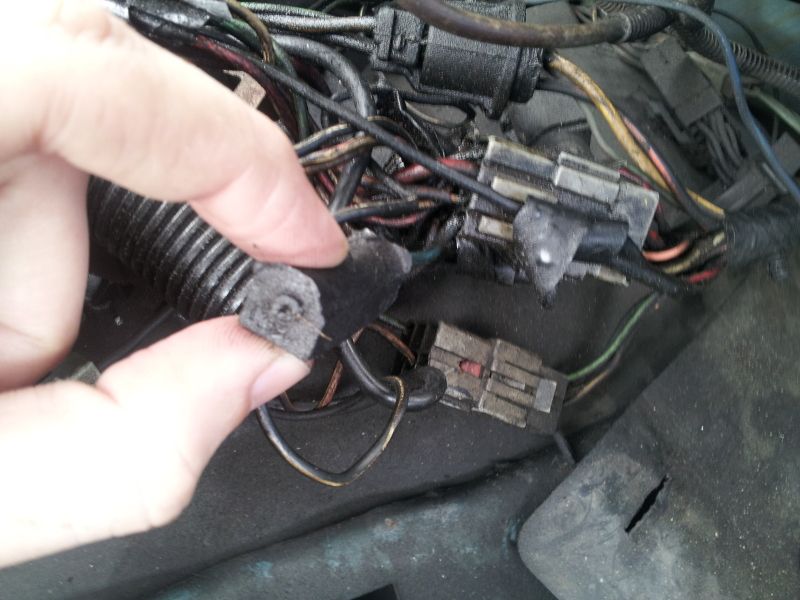

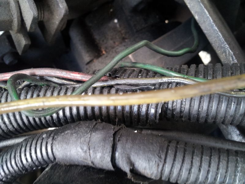

Here are some of the culprits:
Here's the fusable link brown / yellow wire that's broken. Like I said, I believe it grounds out but I'm not doing that until I confirm it with a test light or identify what it's actually for.
(Not leaving it hanging like this by the way!)
It's a bit twisted but it's brown / yellow. This is after cleaning it up with soap and water. Note the right portion of the picture where it comes in...You can make out the brown / yellow much better here.
Here's the other one. Directly off the junction near the coil.
Color is blue. I believe this one grounds out? I'm going off memory again..I'll test it with a light later and try to actually ID on a diagram.

Well, Tomorrow night I plan to put up the "new" wiring harness in the garage and clean it up. While checking over some things on it tonight, I noticed that the Brown / Yellow wire that goes into the fusable link goes to blue on the other end and goes into a multi port connection. It looks like the one that I posted with the blue wired fusable link hanging out of it. It actually goes into that same spot so I dont know what to really think...My "new" harness is from an 87 Bronco II so everything should be the same. we'll see when I start labling.
Tomorrow night, when I hang up the harness for cleaning, I will check the colors of those wires vs the ones on my truck now.
