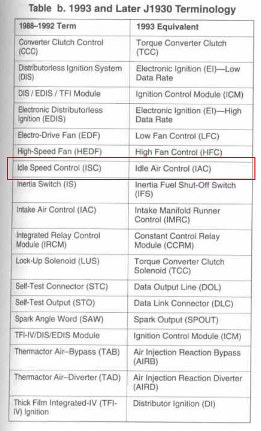

Actually I wasn't off in my initial "ISC" terminology... They just changed it in 1993...
