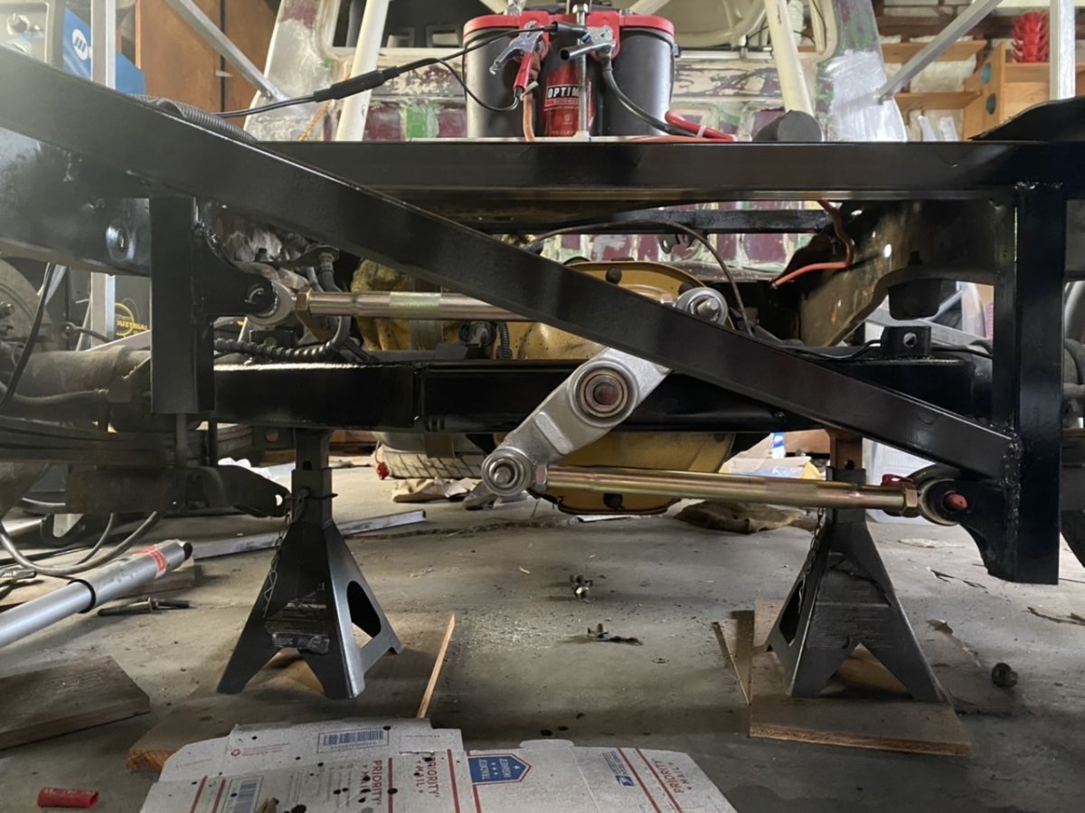

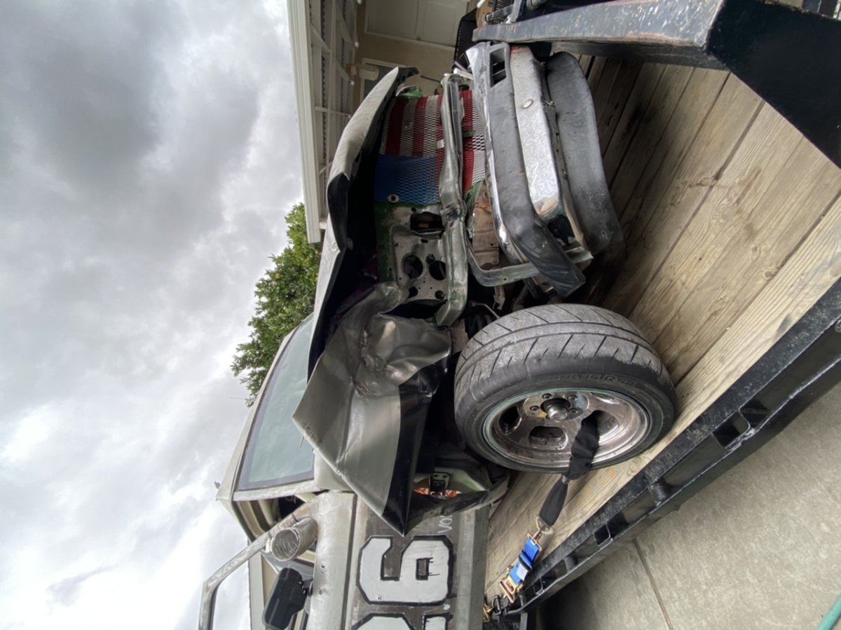

I bought a 2.5-2.75 silicone reducing elbow to use as a short ram. The battery is relocated to the rear. I also built a Watts link for it.we were in a pretty big wreck last year and cut the front off of another ranger (that’s still sitting in our driveway, much to my wife’s delight).
repaired:
Before:
75330
Watts, we have shorter tubes on it than this photo:
75332
