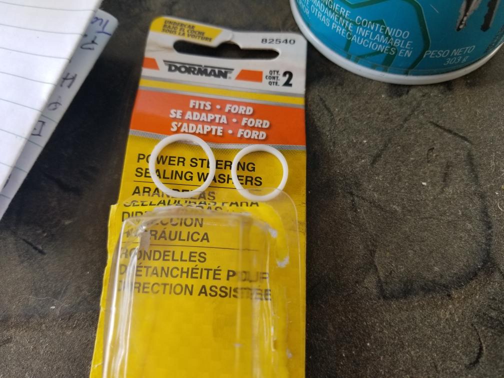

I went to the Auto Zone site looking for a new ho$e, they have it for $106.00 and below have the "also often purchased with this item' listed DORMAN HELP # 82549, a $6 package of two Teflon O-Rings specifically made to seal the pump end of the pressure hose .

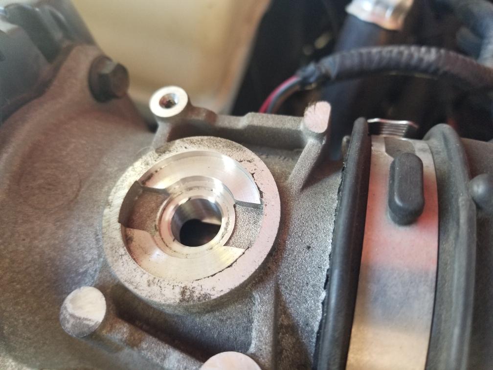

Today's job was the leaking hi pressure output fitting(s) , I replaced the Teflon O-Ring between the hose and the outlet fitting, this is what came out :
Here's the Dorman Products HELP Teflon O-Ring kit :
I used the smaller one, it fits right in the hole left when you remove the pressure hose using an open end 18MM wrench .
I buttoned it all up and cleaned everything dry, started it up and ran the steering left & right a few times to fully bleed it, no drips, excellent .

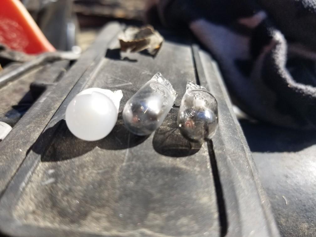

I repaired and re routed the driver's side park lamp wire my dang dog chewed in 1/2, then added some nice LED bulbs to replace the original failed GE incandescent ones :

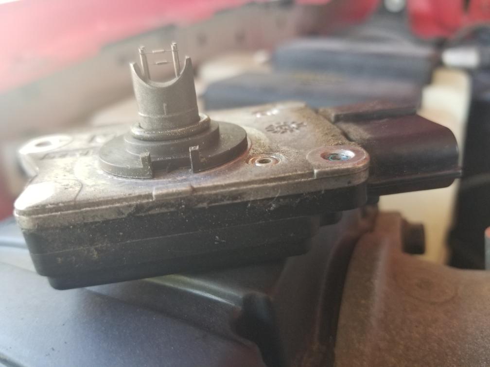

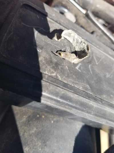

As long as I had the inner fender liner off I cleaned it up so it looks near new again then I moved on to the MAF sensor , I'd removed the entire alloy block and sprayed in it before but didn't see anything dirty, searching here I found a DIY how-to remove the actual super delicate sensor for proper cleaning ~ I had to go back to the Partshaus yet again and buy a set of special "Tamper Resistant" Torx bits,then it came right apart using the T20 size, here's what I saw :
If you look closely the lower thing is a different color, in the flesh it looked black .
I sprayed it with CRD MAF sensor cleaner spray and Lo ! that lower thing (looks like a tiny resistor to me) turned the same color as the upper one, I figure this can't be a bad thing , the alloy hiusing only had a little bit of accumulated crud on it :
I cleaned that Hospital Clean and it runs better, especially at low RPM's when pulling away from a stop or hyper miling it .
