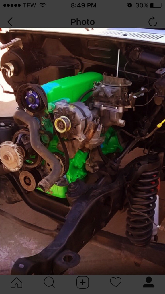

The style of mount I have (pictured here) I believe to be the culprit.
The issue seems to be that I have to pull the alternator so tight against the belt to keep it from squealing (and yes I've replaced the belt several times) that it puts too much strain on the bearings in the alternator and wears them out prematurely. The latest one lasted maybe a month and is now starting to go out once more.
What options to I have for putting a different style mount/ alternator on my truck or are there any tips/tricks to solving this issue.
And simply because more info is better, the truck only has water pump and alt ran on one belt. No p/s and no a/c.

Thanks Ron. As always, good info. I always thought it was the belt itself glazing over but that makes perfect sense that it would be a pulley and probably not the alt pulley. When I put this last alt on I also replaced the belt with it and it didn't squeal at all for a week or two then all of the sudden squealed like crazy so it definitely makes sense for it to be one of the other pulleys causing an issue.
You might want to check your water pump. If it's bearing is failing, that might be the pulley that is squealing. There is no reason that you should have to tighten the belt so much that it damages bearings. With 50 percent wrap on the alternator pulley, it should be last pulley to slip.

Yeah I'm definitely going with sanding the pulleys first. The water pump was replaced when I rebuilt this motor roughly 4k miles ago so it's unlikely that the bearing is going out but if sanding doesn't help than that will be the next suspect.
And I don't think it's the alternator pulley itself squealing but pulling the alternator tighter pulls the belt tighter against the other pulleys that are squealing main suspect being the water pump that gets less than 25% wrap.
