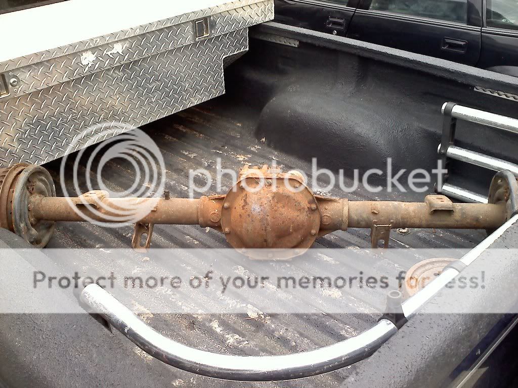

this is my first post in the axle section, though ive been a member since 2007. im going to be setting up a 7.5" with a set of richmond 4.10 gears and a lock rite (as soon as money permits, its sitting on the shelf at work just waiting on me to get the $$$). this will be my first time setting up an axle from scratch, but ill be doing it on a work bench and since its not in the truck im not in a hurry to get it done, i just want to get it right.

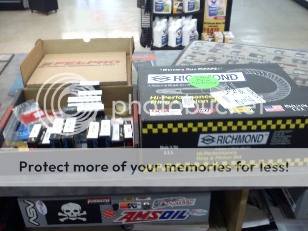

so far ive got the donor axle (not sure of the gear ratio yet since i havent opened it up and theres no tag on the cover), the ring and pinion set, pinion and carrier shims, the replacement bearing set with seals, new crush sleeves, ford marking compound, a dial inicator with magnetic base, and a spare inner pinion bearing so i can sand down the inner race and use it to check my pinion depth.
is there any advice you guys have or tips you can give me other than dont do it your self?

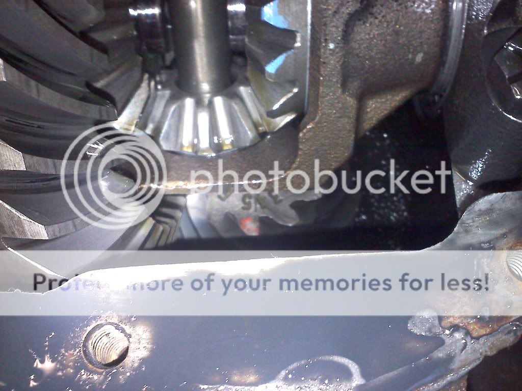

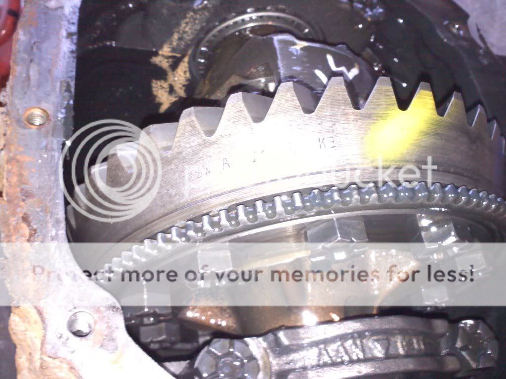

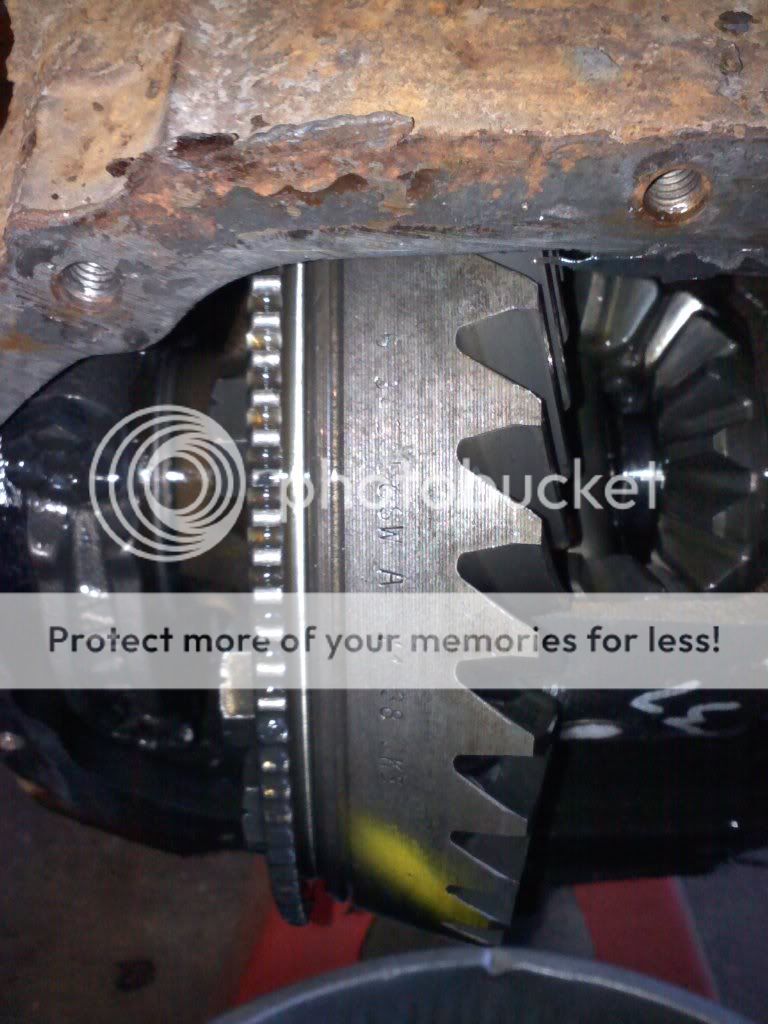

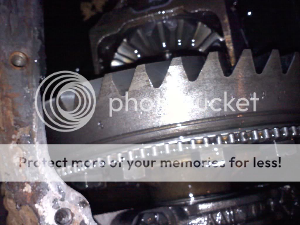

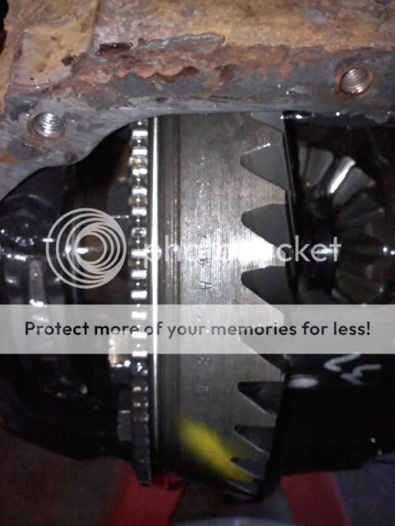

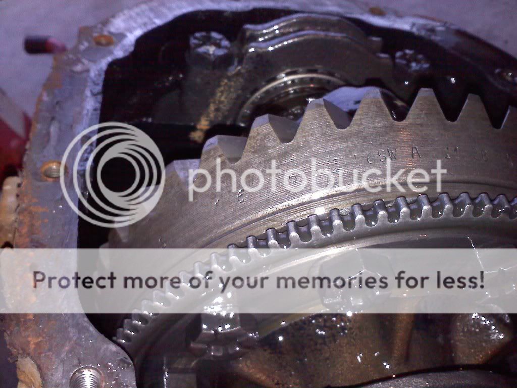

i got home from work and decided to pop off the cover to see if i could figure out what ratio was in there, but i couldnt make heads or tails of it so i took pics in hopes that they would be legible and some one could tell me what they are.
it looks like it says " 6 342 6 SW A something 28 2K3 "? i guess its not really important what was in there, the fluid looked clean (black but no water was present) and the spiders look fine, so ill just keep gathering info until i have time to start on it.
Count the teeth on the ring, divided by teeth on the pinion

As Farmer said, just count the teeth of the ring and pinion.
ill check the tooth count when i get home tonight, my truck broke down this morning and after missing out on 4 hours of work Fing with it i got it figured out and now im just waiting on parts.
well i didnt get lucky eoungh to end up with 4.10s in the axle already, but thats ok cause i was planning on having to do the full job anyways. its got 3.45s in it now, so as soon as i finish clearing out a space on the bench to work on it ill be posting more pics.
