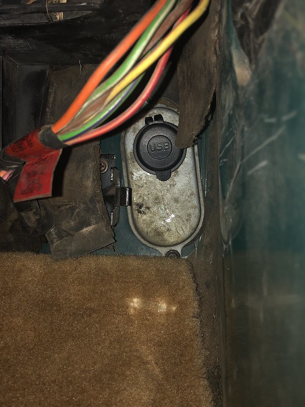

Don't remember if yours is carb or EFI but there is a large grommet in the firewall under the blower motor for the PCM harness to pass thru, if you went from EFI to carb it would be open unless you plugged it.
I just stuck a bolt in mine to plug it until I snagged the regular blockoff plate from a 2.0 truck.
Blockoff plate installed from cab side (with usb charger added)
They could possibly get in thru the shifter hole and travel under the carpet to come out somewhere else if it isn't cinched down good around the shifter. And even if it is they could still tunnel in the jute/insulation if they had to.
If they can get up onto the cowl, they can crawl through the slots and then into the fresh air flapper which leads directly into the HVAC ductwork inside the cab. You could put some screen inside the cowl...would also keep leaves out of it.

Right now nothing, on our road trips cell phones. They ride in the cubby on the dash and the cords stay more or less out of the way.
The block-off plate for the harness in the firewall is being used. I've already checked it. Good to go..
