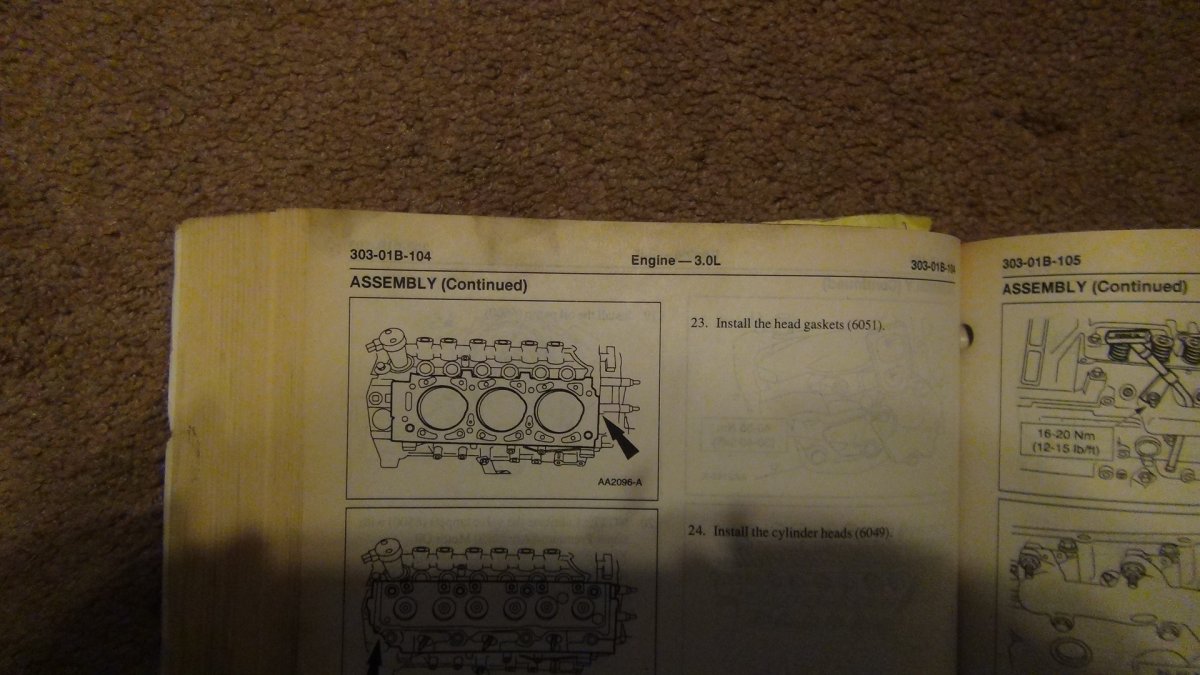

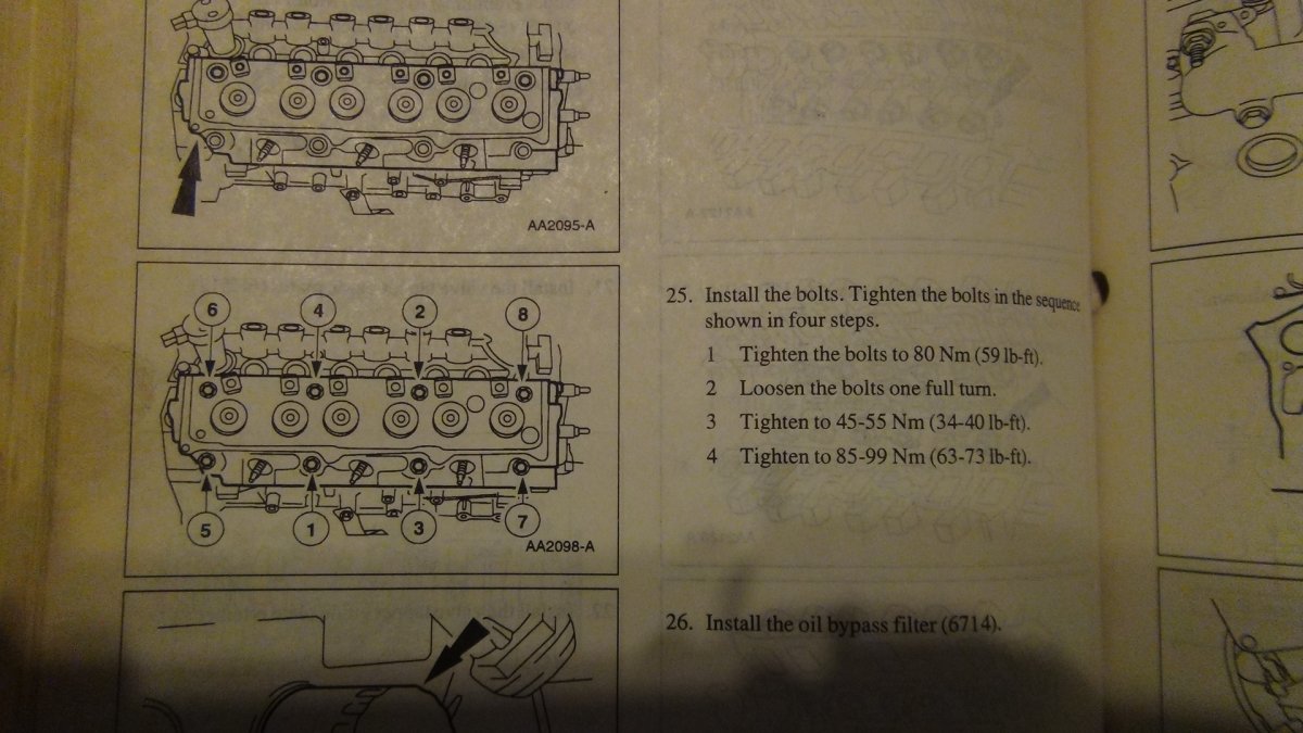

Had to replace heads on 1999 ranger 3.0 engine. Got new head bolts (Felpro ES 72174) and I have the Ford 1999 Ranger workshop manual book 1. On page 303-01B-104 in that book it says to 1- tighten bolts, 2 - loosen bolts, 3 - tighten again, then 4 - tighten again. I used the max numbers on that spec, so I first tighten to 59lb-ft, then loosen up one turn, then tighten to 40 lb-ft, then tighten again to 73 lb-ft. Is that it? No TTYing is mentioned to do on this page. Almost got the engine put back together, but if I needed to do extra turning (TTYing) than what this Ford OEM book says to do, then I might loose my religion and cuss like no means thinking I will have to tear engine back down again to do extra tightening (TTYing) Just want to make sure I did this right and OK with what I did. Ford Ranger's head bolts

That last step #4 to tighten to 73 lb-ft. Is that the yielding?
Did you get new head bolts? I'm not saying that you needed to. Some engines are one time use, others are reusable, I don't know which the 3.0L is.
Rereading your post I see that you did get new head bolts.
Did they come with instructions?
Sometimes head bolt makers will have special instructions for their headbolts that differ from factory specifications. If none were provided go with what the service manual says. If you did through step 4 then you are done. Not all engines have TTY bolts that require a degree turn after finaltorque step.

OK I see it has been moved. Hopefully will get more views and responses. And no the bolts didn't come with instructions. So I think I might be OK but just not sure. I looked up the Felpro head bolts that I bought and few websites says they're TTY but most don't mention it. Even Felpro.com don't mention that they are TTY but does says this about them:
  • Meets or exceeds all original equipment specifications
  • Application specific design to ensure a perfect fit
  • Avoid risk associated with re-use of T-T-Y (torque to yield) head bolts
  • Validated for fit, form and function
  • Unsurpassed quality you can trust
FelPro didn't include special instructions, so they wanted you to use manufacturer instructions. If they are TTY, the factory instructions torqued them to the point that they need to be. If they are not TTY, the instructions torqued them to the point that they need to be.
To quote a YouTube personality: "A man can worry a thing to death" -Derek (VGG)
Stop worrying about it. You followed the instructions, trust them. You've done that part of the job the best that you can. If you have issues, it probably won't be because of the torque on those bolts.
