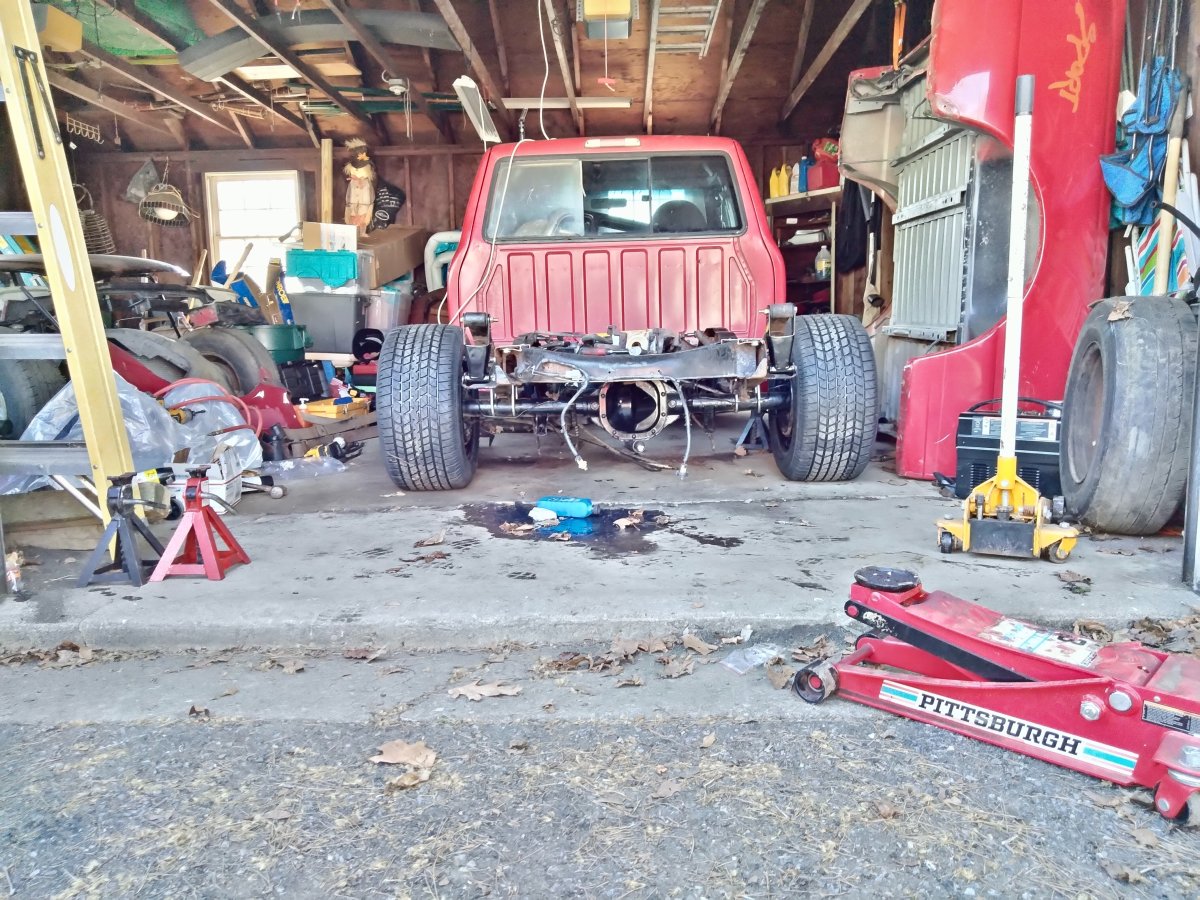

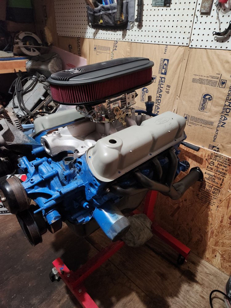

Hello I am looking for some advice with my project I have a 1999 ranger xlt 2wd was a 3.0 I have a 302 roller out of a 1995 f150 and a 2004 m5od-r2 with a 28 spline 8.8 with a mini spool I am running a dual plane intake with a holley 650 I'm looking for some aduve for the clutch set up and also the drive shaft and hooking up some other things like the speedo and fan set ups I'm up for any suggestions thank you

It looks like hood clearance will be an issue, you can use Body Lift to get more room, or use a different intake or air filter setup

Thank you for the input as far as hood clearance I'm probably going to run a hood scoop because I'm going to need a carb spacer for the hei distributor and the rear is from a 99 ranger so that will work fine then
