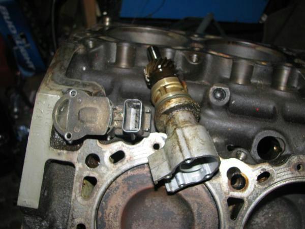

I have a camshaft and crank shaft position sensor but cannot locate where the camshaft sensor is on my engine. Can anyone help me out here?? Pictures would be greatly appreciated!!!!! It is a 1994 half year 4.0l v6 pushrod engine manual transmition 5speed.
the cam position sensor is at the far rear of the block. it is very difficult to see or reach without removing at least the upper intake, coil pack and possibly the lower intake manifold. i've only had to deal with the cmp when the engine was out of my truck.
http://www.therangerstation.com/tech_library/4_0-camshaft_synchronizer.shtml
http://www.therangerstation.com/tech_library/camshaft_position_sensor_cmp.shtml
