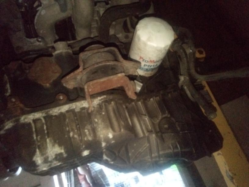

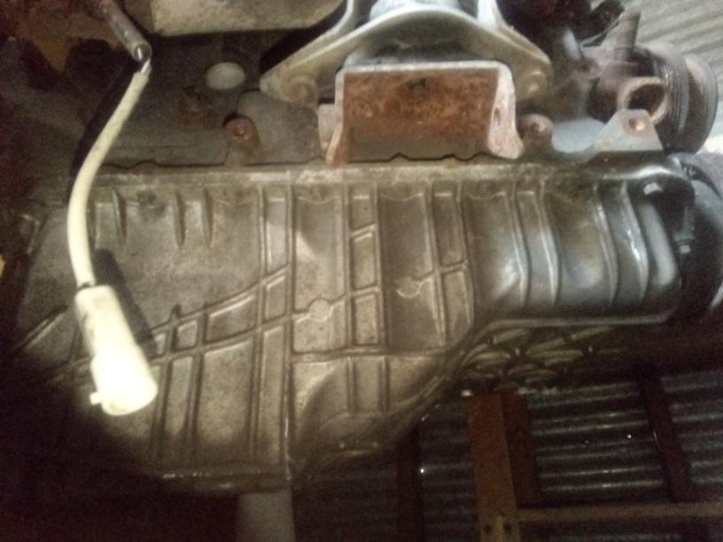

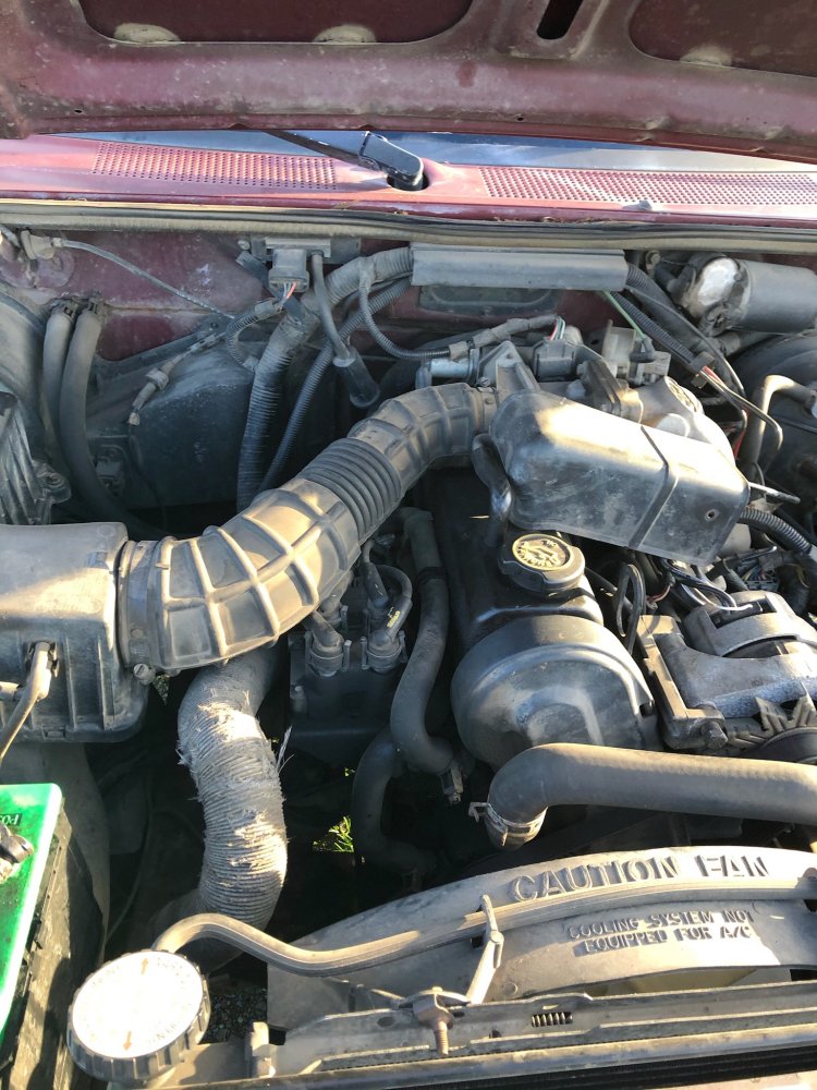

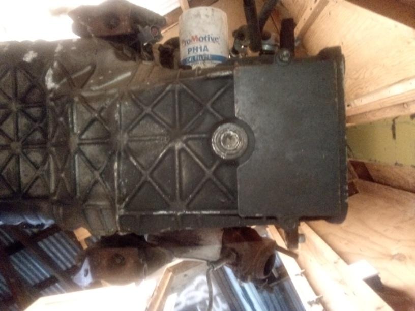

I arrived in Eugene, OR from Hawaii last Thursday morning. Picked up new motor and prepped truck for swap in afternoon. Pulled old motor on Friday. Installed new motor on Saturday. Tried to start on Sunday but ran into a "no spark" issue. SHOOTS! Packed up and flew out without getting motor started. Oil pan was an exact match. No clearance issues to speak of. The ratchet strap method worked like a charm. I unbolted the rear tranny mounts and driveshaft u-joint bolts to allow tranny to float. Way easy. Check out the HUGE hole in oil pan of old motor. Did not have time to open up pan and determine cause of the hole but a part did drop out during removal (see pic). Any ideas what this is?

OK. So tried to start new motor and it turned over but no start. Pulled the #3 plug on passenger side (as it was easiest to access) and tested for spark while cranking motor. No dice. Sprayed some quick start into intake while cranking. Nothing. Checked battery voltage and got 11.9 volts. Tested voltage between both coil pack terminals and ground (middle plug of three) with key in ON position and got 11.7 volts there. Tested voltage between engine block and + terminal and got 11.7 Volts there. When I did the engine swap I kept pretty much everything from original truck (intake and fuel rails, all sensors, etc) my idea being that truck was reported to be running great before the mechanical failure. The only things that changed were: Crank position sensor (the old one was spliced in ground wire and new motor one appeared to look better), I removed what I believe was the oil level sensor from old motor because new motor did not have one and I could not swap oil pans (for obvious reasons), I swapped a few of the spark plug wires since some of the old ones got mangled when I removed old engine. One thing I did notice is a difference in the spark plugs from new motor to old motor (see pic below). The plug from the '93 mustang is on the left (an Autolite product) and the plug from the original '90 motor is on the right (forgot the manufacturer). I did NOT swap plugs in the motors because of the obvious difference.

Just realized the pics of the old motor coming out and the new motor going in are not labeled correctly. Its the other way around. The new motor going in has fan attached (which I had to remove in order to get it in! haha)

I'm not sure what that is that came out of the oil pan, it is in the oil pump area, could be a pressure relief in the oil pump or something, been a while since I've had one apart...

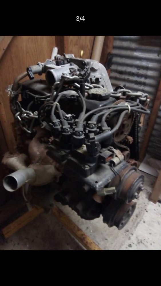

Are you still interested in the spare parts after the swap? Since I have no spark I may need to source the extra crank position sensor, coil packs, and ICM. There's still a bunch of other good parts including: block, crankshaft, heads, etc... plus exhaust and intake manifolds. Located in Springfield OR. Will need to take the extra motor + everything in box if you decide you want them. I don't plan on using my buddies place to store old ranger parts!
Here are pics of the remaining parts:

Yes, interested, if I can find my spare parts I have a spare of all of those... I don't think they're too buried...
