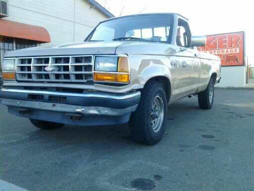

So Im a little new here but I hope I can get some help. I finally got up to my dads shop and got a new different reader onto my truck to check my CHECK ENG light problem..... Well "problem's". it pulled back three codes that could not be manually erased. They are :
(223)Dual Plug (DPI), SPOUT or IDM circuit fault - Ignition Systems
(224)Failure in ignition coil primary circuit - Ignition Systems
(452)Vehicle Speed Sensor (VSS) problem
So i believe (223) means I have a bad circut with a dual spark plug system but i have not one clue where to start with the duel plugs. Ive never messes with them before. (224) should be the coil for the dual plug right? and (452) Im not to sure on. Is it a Transmission Speed Sensor?:icon_confused: the only thing wrong with any of that is that my Rpm Gauge is stuck at 3500. Im looking to find out what I need to replace within these codes to get my check engine light to shut off. If anyone can help id greatly appreciate it. Thanks
