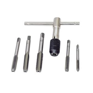

i got a tap wrench set and some helicoil inserts. the pump bolt is a #m6 ,, does this mean i use the #7 tap?, the #7 tap and the outer diameter of the helicoil "look" close but i dont know for sure.
Allso i found a nother #6 at lowes thats about four threads longer,, should i try that first? I dont want to bust a water jacket or nothing trying..

I'm not sure the external threads of the helicoil are standard. If you buy the kit, it normally comes with the proper drill and tap. At a minimum, the package will probably tell you what sizes to use. The installation tool is handy also.
