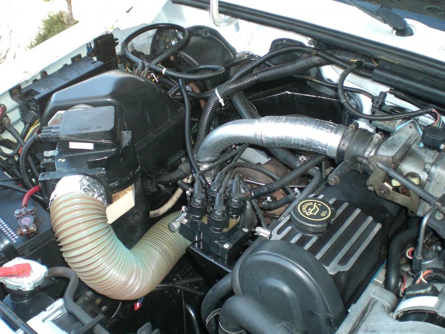

After going nuts trying to find 3" flex hose, and building that ridiculous, shiny aluminum adapter; I remembered that my RV's sewer line is 3".:icon_idea: I like this set-up much better even though it was a "crappy" idea....:dunno: (sorry, couldn't resist)

I have a feeling your exhaust tube intake is the cause for the WOT miss, these systems don't like air metering problems either way, anytime air gets in or out after the VAM they'll run kinda weird. I think my VAM has a dead spot in the highway cruise area of airflow because it will run just fine with more or less throttle. It's gonna be my excuse to upgrade to the LA3 computer I have and find a big VAM, but I gotta wait til I have time to do that, it runs just fine other than cruising at 55mph, 50 and down or 60 and up is fine, but it doesn't like 55...
I know what you're talking about with the S-10 shifting. Dump truck like shifting, and yes the Ranger is way better than those. I had about 4 of them over the years until I decided a Ranger was the way to go. I'm just going to have to go through it and rule out a clogged fuel pump and crappy, old gas. It runs really good until you hammer it; then it starts sputtering around 2700rpm, and it really don't like to run past 3000rpm without missing. It fails right in the sweet spot where everything lines up and it should just jump out. I have good, leak free connections from my VAM to turbo and turbo to intake. At least it's running; it's just not "screaming" yet. I'll get there. I wonder if my 2.25" straight pipe exhaust system is messing with anything? I'm going to put a turbo muffler in before I take it cross country. It sounds like a diesel farm tractor. lol I found my big VAM on ebay, there's a shop selling re-conditioned ones for around $118.00. Kinda pricey, but it arrived nice and clean with all the wear prone parts replaced with new. Probably could get one at NAPA for that kind of money though.

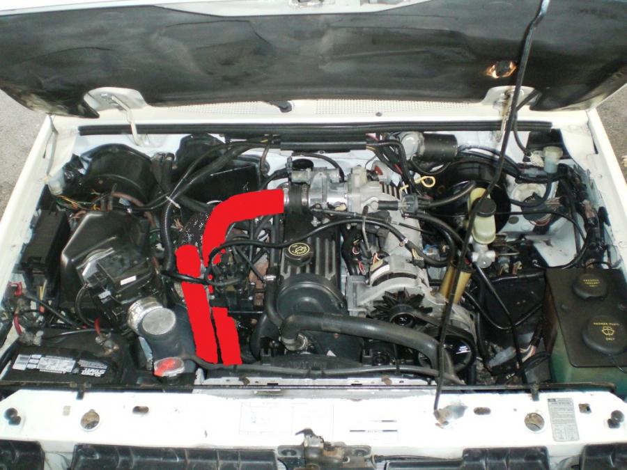

Spring is finally here, and I'm itching to start body work and paint. I really like the original color scheme, and think I'll stick with it. Also, have the engine running right, and have things more or less the way I want them under the hood for the time being. It's a bunch more fun to drive now! :D I'm planning to install a welded, stainless steel header and put an intercooler in the mix. The red lines in the photo are where I's like to run the piping. It wouldn't require turning the intake and there is plenty of room to add piping that way, but it would increase the overall length of the piping required. I'm not sure if that's an issue or not. Very pleased with the way this project has been going.

Lots of people run rear-mounted turbos and seem to be fine with the increased boost lag that comes with 10 feet of intercooler piping, I'd think you'll be fine. Though you will be running your intake pipe right post the header, increased intake temp would be my only concern. Good luck!

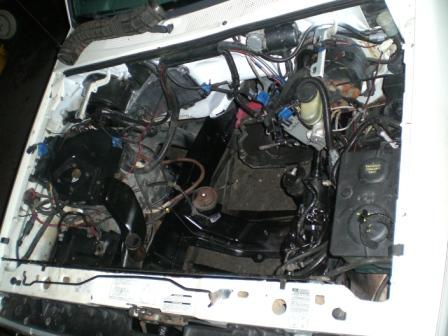

It's coming along, slowly! Hopefully fire it in a few more weeks, got some rain here today so going to try and finish up the transmission clutch slave and master then on to the wiring. All the factory harness is garbage, all rotted at most of the connectors, and the harness I got from the wrecked 2.3 truck is ripped up pretty good, so fun times ahead! :bawling:
