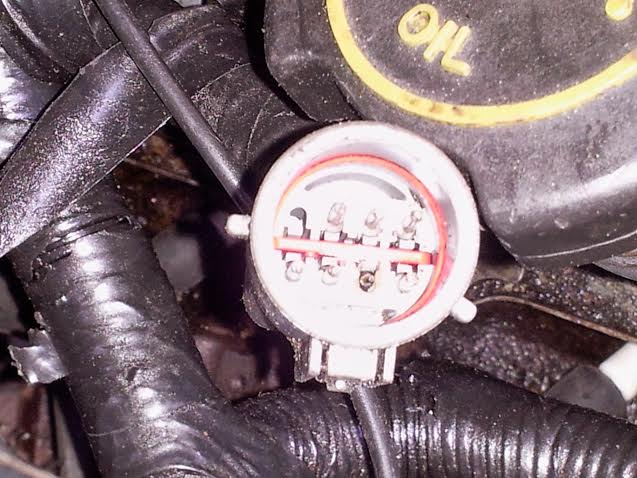

I think the pic says it all . That's the 12V+ to the TFI that was grounded . Red with light green wire
Pin in the connector go POP!
Waiting on a few wiring parts I didn't have .
More in a bit .

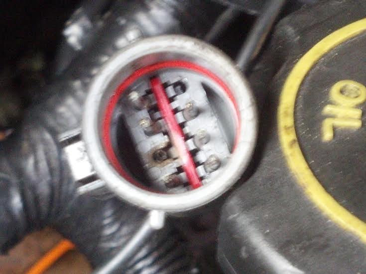

and another ...
Done deal , sis is happy , beer thirty ...
