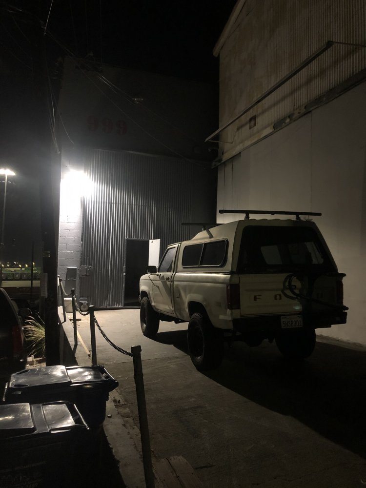

Hey everybody , I want to get rid of my bench seat , any tips on what year/models j can swap with ? Explorers?
I’d like to put bucket seats and not another bench
1987 Ford ranger standard cab 2wd
