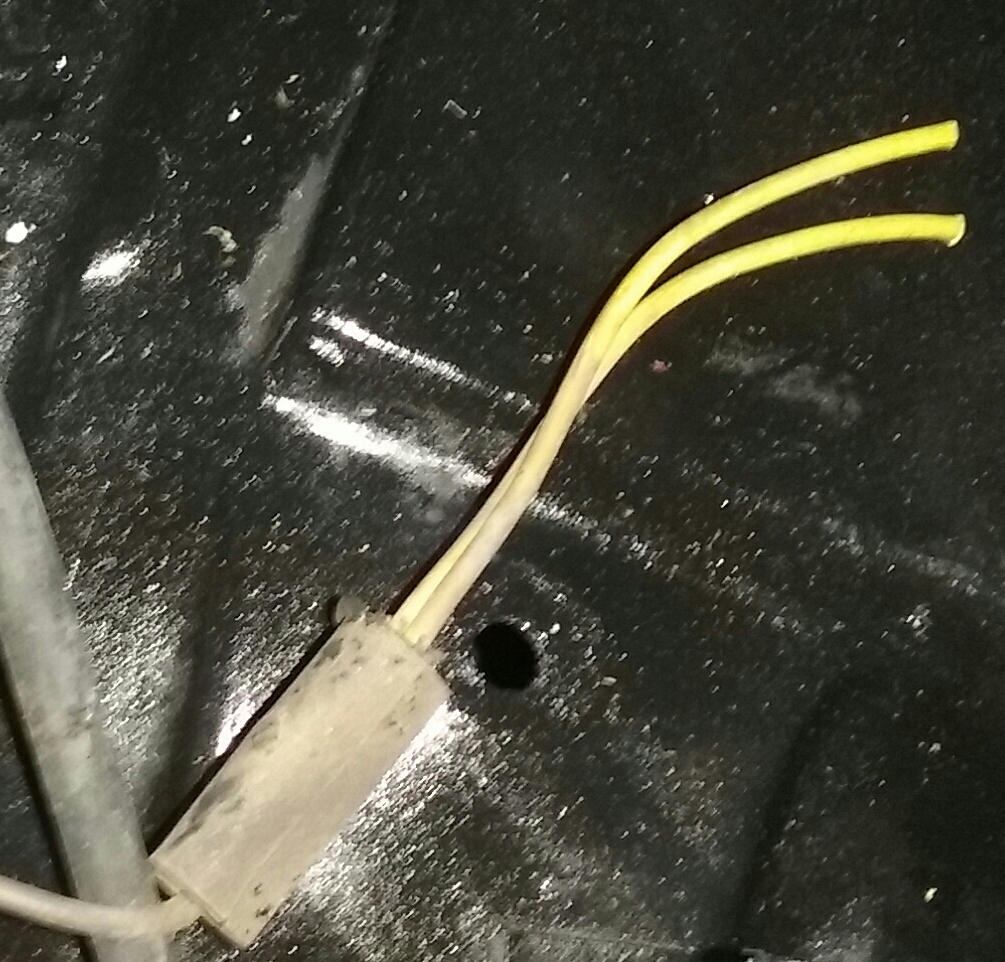

You were right. I finally got a chance to find the wiring diagram on All-Data at work and the small center wire for the long alt. plug goes to the computer for choke heater. I guess I can leave that wire out. The big black/orange wire and the white/black jumper to the regulator plug are still there on the driver's side. I got a chance to look at the yellow wires I cut out of the computer that came off the solenoid. It's a black wire first, then the splitter to the two yellow wires says 16ga fusible link. My question is can i use these two yellow wires as the B+ alt. wires? My '86 only has two black/orange wires on the alt. plug and two on the regulator plug, not three each like the '87. I'm still looking for the resistor wire for the coil+ and apparently the duraspark module itself needs less than 12V. Another question, is an inline resistor something I can see like the fusible link or is it just a special section of wire?

Yeah, I found that trailer wire on my diagram. Odd since the truck isn't even wired for trailer lights at the back. I just left the choke heater wire off the alt. I'll have to wait and see if it charges with just the one black/orange wire. I ran into ignition problems now though. I thought it was going to work bypassing the computer and using the stock ignition. I have power to the coil and to the duraspark box but no fire at the plugs. I'll give it a few more days of tinkering before I give up and get an aftermarket ignition box. FYI a Pacesetter header will NOT fit my '87 Ranger without grinding a cutout in the top frame rail for the #3 tube. That's what I'm working on now. Then it's on to rigging up a throttle cable or rod for the 2100 Autolite carb.
It worked!! The truck is running with its stock distributor and duraspark box and without its computer or feedback carb. I just used the alternator wires I had that were in a separate harness on the driver's side and just left out the center wire for the choke heater and it's charging like normal, a little over 14v. The wire that goes to the S terminal on the solenoid went through the computer also so I had to figure that out. I mistakenly hooked up a wire to coil + that wasn't hot in START. Once I found the wire that was hot in START and RUN the truck fired up. All the wires for the coil, ignition box, gauges and the power to the relay in START mode only are all together in one rectangle shaped plug on the driver's side. Basically you just have to figure out where each wire winds up after the computer and run new wires to each. The plug looks basically identical to the plug on my '83 F150 so I probably could have used an engine harness from an older Ford. The backup lights go through the same plug and I still need to hook those up but everything else is working. It actually looks like there's some room under the hood now and I'd figure I pulled out a good 5 pounds of wires, relays and the computer so lighter is always better.
