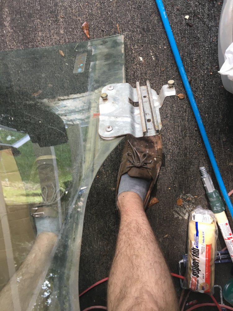

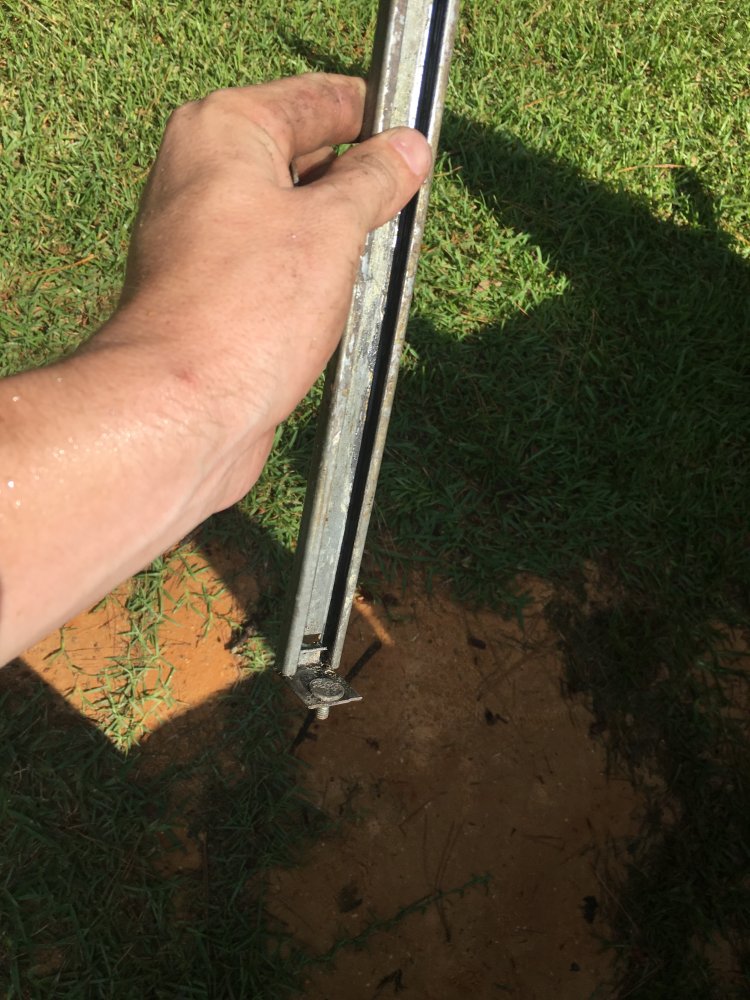

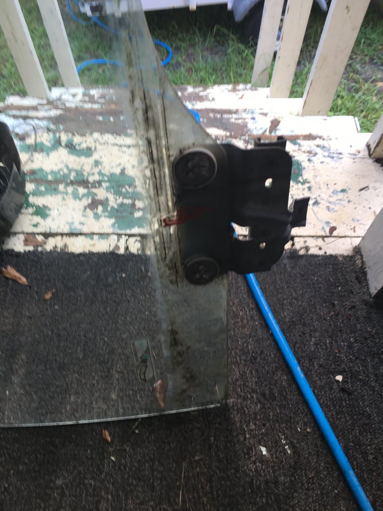

Well for future generations here is what I ended up doing. I gave up on finding the plastic window holder thing and went to the 87-92 steel one, better longevity with the steel as well. I bought it from the local u pull it both windows and tracks for 50 dollars. You will have to have the tracks unless you are good with the window sticking up a 1/2 inch when all the way down. I started by drilling the rivets out of the window to disconnect the holder from the window. Next I removed the old track from the door and and put the new one in with the holder placed in the track to reassemble the window to the holder I used two 5/16 x 1 1/2 bolts with nylon locking nuts. I could have went shorter with the bolts to a one inch maybe.
