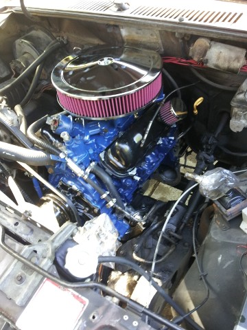

Ok guys, finally got the truck finished about a month ago. Holley sniper works like a dream and having a electronic controlled OD trans is awesome. I'll post some pics soon.

Actually I want to eventually get a long travel suspension setup. I think this truck would be fun as hell with all the power and the ability to run anything over. The sniper system is awesome. Its super simple to install and tune. I did have a few issues with the tune as it started learning. But Holley was able to walk me through fixing them.

Guys I'm having a issue with the timing on the swap. I have the Holley dual sync dizzy controlling the timing on it from the Sniper system. I'm having a issue finding how much total timing the stock 351W needs? Anybody know the factory specs? As I have mentioned it is a 1996 351w out of a E-150. I can set the timing to whatever I like easily, I've started at 34* and noticed some bogging at full throttle. So I changed it to 32* and this is where I have it now. It made the bogging a little less but I'm having issues trying to match the AFR now with the change in timing. So I want to completely start from scratch with the engine but I can't seem to find the correct specs for the stock engine. I figured the factory setting will get me to the ballpark as its basically a stock engine. Different intake is all. Any help?

Quick update, trucks been running great. Had some issues with original Sniper unit. Holley said it was s/w issues because my unit was so new when I did the swap. Anyway I sent it in, they loaded new software and has been running great since. Just put led light bar on. . ?
