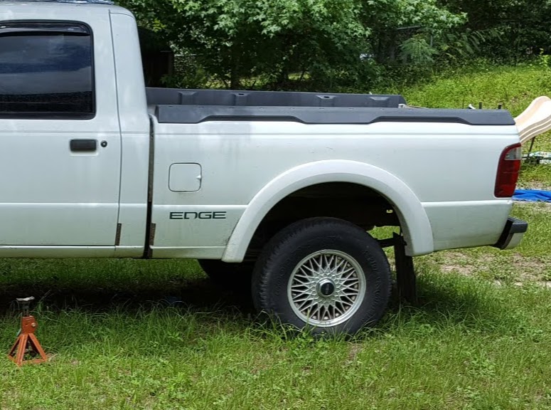

I really like the look of the CVPI's but always wondered how much each one weighs, compared to the aluminum LTC 15" that I have now.
These came off a 95 Lincoln Town Car. No spacers needed

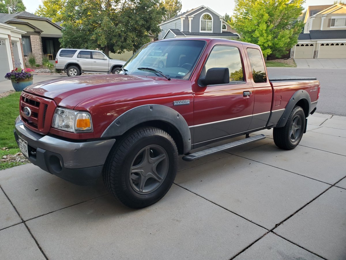

I have 1.25" adapters on my 09 FX4 with Mustang wheels on it. They work just fine. You will get pushback from some tire stores though, because some of them have rules against spacers or adapters.

I've been running a set to allow me to run Mustang rims for over a decade now without problems.
