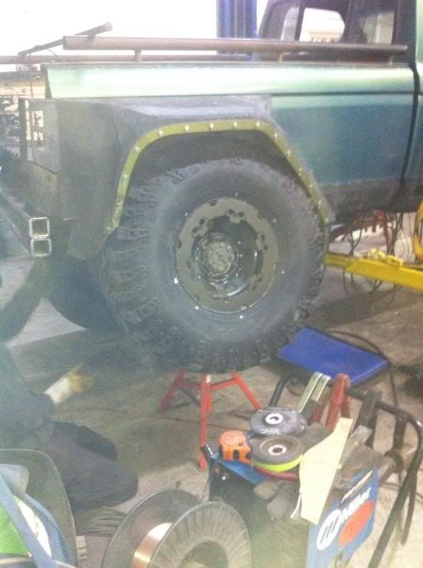

little tires
big tires

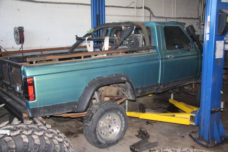

part of the 4 link

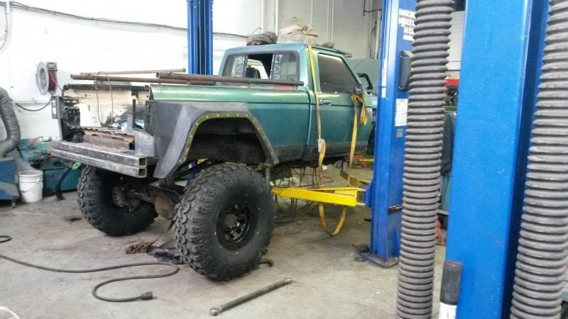

completed 4 link just waiting for shocks

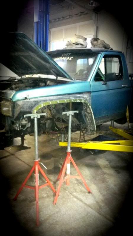

new front fender
tire sure fits well eh
