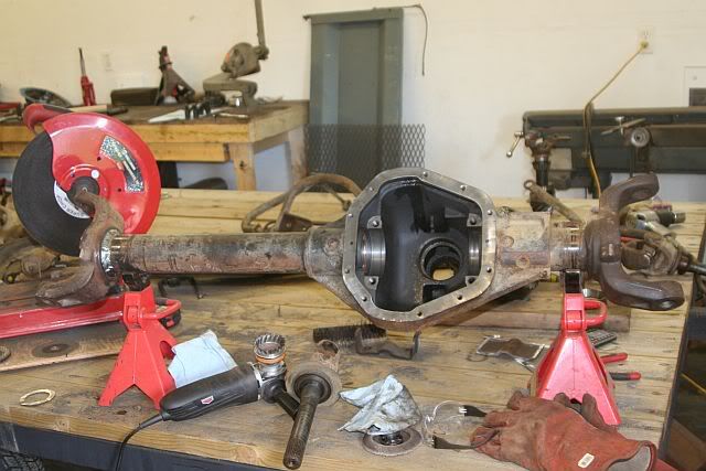

Trim back the cast on the drivers side so you have room for a link/shock mount.

Did you heat up your inner C to get it on like you were talking about?? How did that work out for you??
SVT
I'm sure he'll come in and answer, and I can't find where he said it, but I remember reading where he said he tossed it in an oven or something. He was able put it on with some light taps from a hammer. Measured, measured, tacked, measured, welded.
It was a bbq and he used welding gloves to grab it its in his thread
Yep, that was it. I didn't want to say a grill and sound like a dumbass. haha
Wife woulda killed me if I tossed it in the oven. I put the BBQ on high and tossed the inner C on it while I prepped the housing. I would suggest a couple pairs of welding gloves as I made it about halfway across the yard to the shop before it started to burn through a single pair of gloves. It went on pretty easy, would have been even easier if I would have left it longer (I've heard about an hour will do) but I was impatient.
Bring the bbq into the shop lol then you dont have to hold onto the c for as long
