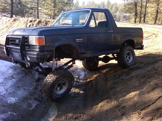

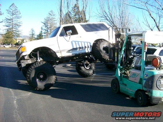

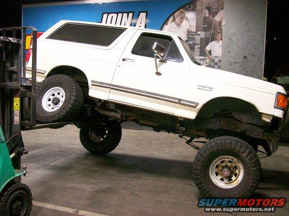

Like this:
Although I like Bones's setup (yes they are both B2s) and he runs coils.
