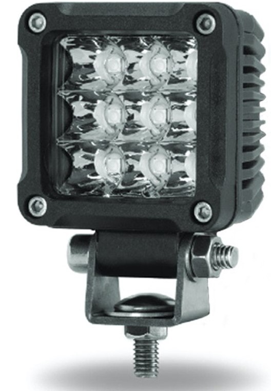

Long shot, but I don't see it mentioned: are your tail light bulbs stock incandescent types, or are they aftermarket, such as LED?
Good question. When I bought this truck a year ago it had two LED lamps mounted on the bumper which are used as backup lamps only. The original lamps are incandesant brake, sinal and park lights. Attatched picture if of similar LEDs that are mounted on my bumper.
