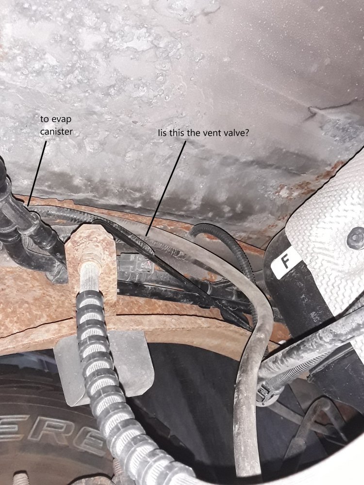

Any Idea about why it has 3 wires. Im assuming 1 hot, 1 ground, the third is a signal wire of some sort?

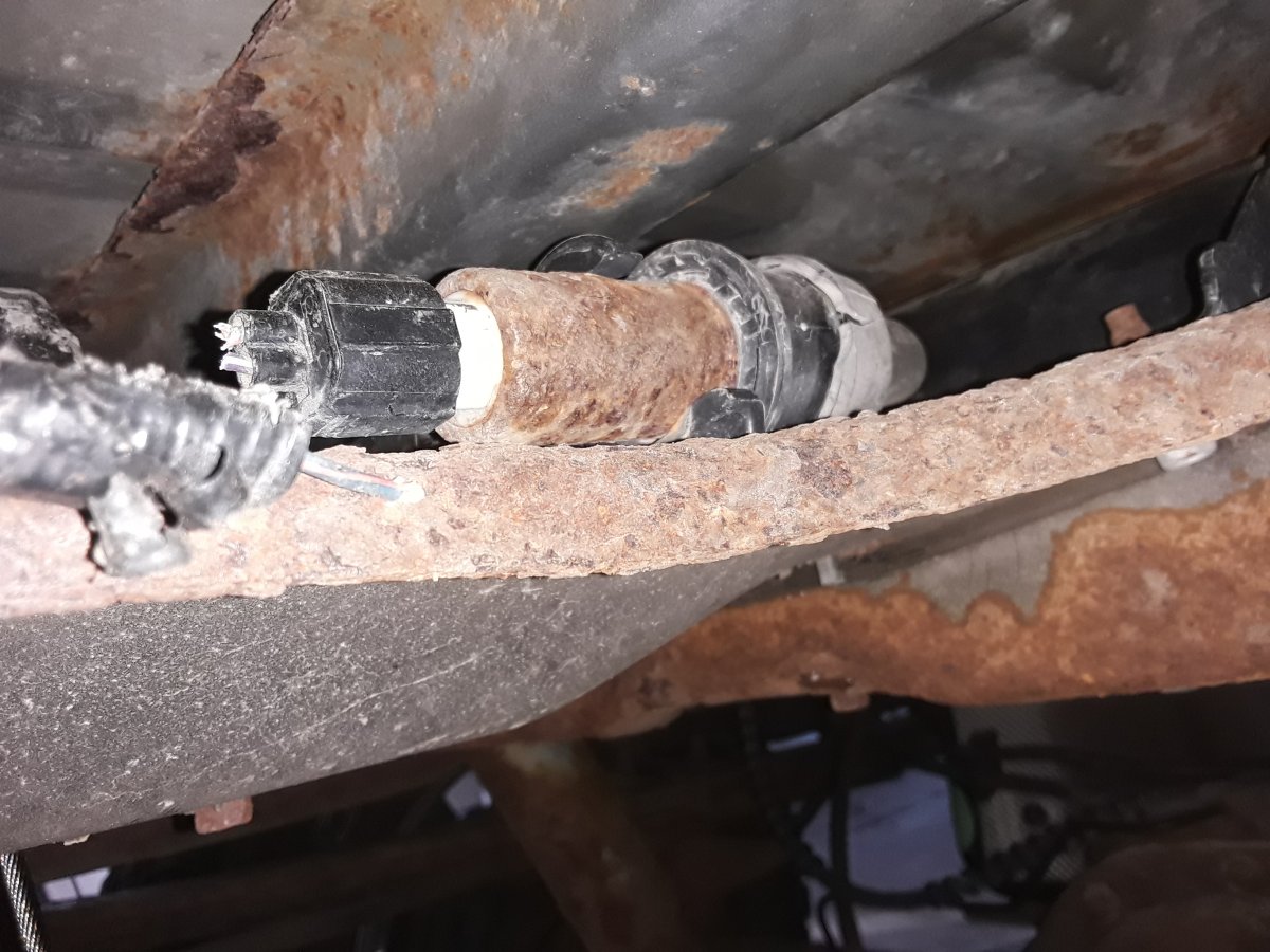

Attaching a couple pictures to make sure I know what Im looking at. I think its the tank pressure sensor. If it is where the heck is the vent valve?

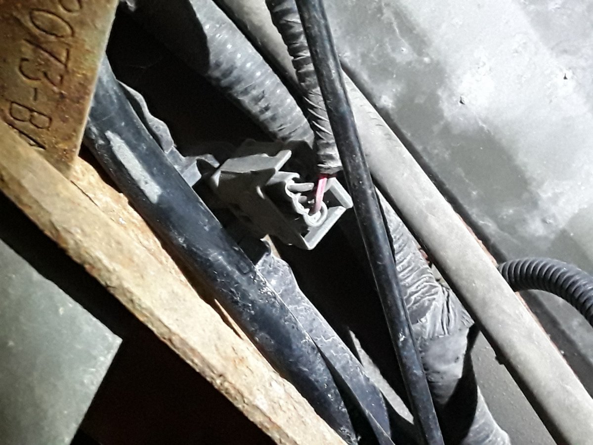

Finally found the vent solenoid, anyone want guess why I have a code?
Thanks RonD, you sent me down the right path with your question and information. Your awesome.

Now to see if there is a pig tail available to repair the problem. Make sure you seal the splices well so the wires don't corrode at the repair. Heat shrink works the best. After soldering the wires, applying a little dielectric grease, then heat shrink is even better.
Found a pigtail, and paid dearly for it cause I cant really wait to fix it due to not wanting to gamble on better weather than today later down the road. The pigtail actually came with the little metal butt splices and heat shrink. That was not really a very comfortable place to work.
