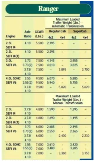

Hey again, so recently I've wanted to start a lawnmowing business with an old lawnmower my grandfather has no use for anymore, and I need to know the towing capacity/abilities of a Ranger with the 2.5 and 5 speed. Surely it can't be high. All im really gonna plan on towing is a small trailer and a ride on mower.
This is for the 01 Ranger

Unfourtantly physical ability doesnt matter to law enforcement.
Only fords stupidly low numbers.
