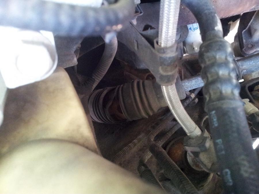

When I popped the hood I saw the boot for the intermediate shaft is busted (picture below). Could this be from the intermediate shaft, or does the entire rack need to be replaced? Or could it be something else entirely?

Looks like the boot ripped and ya lost all the grease in there!!
Looks that way...so I'm definitely going to have to replace that. Would that cause the popping?
Try tightening the pinch bolt on the joint where the steering shaft attaches to the rack spline.
