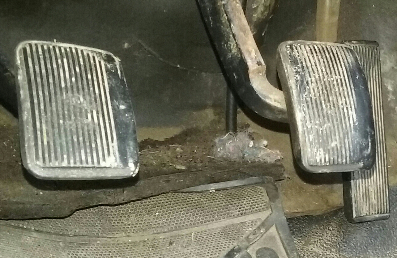

I've got an '87 Ranger with manual brakes and the pedal is very high. With some engine upgrades and no choke I sometimes have the need to heel/toe it at stop lights and it's impossible. The brake pedal is 10" higher than the gas pedal and only goes down about 2" at full brake. It's probably 2" higher than the clutch pedal. Is this normal? The brakes work fine. I have an '86 with power brakes and the pedal goes down right beside the gas pedal. I have noticed I can pick the brake pedal up to the dash with my foot and let it fall back down. The pushrod doesn't have any adjustment, it just hooks to the pedal and shoves into the master cylinder. I highly dought someone swapped it to manual brakes as the truck has no PS,no A/C, not even a radio, so it's definitely a base model. Anyone ever heard of this?

I’ve never heard of manual brakes on a Ranger. Can you post some pictures?

Ive had 2 1st gens with manual brakes. Both of mine were close to even with the clutch. Maybe 1/2" higher. IIRC the pushrod for power brake booster is longer. Maybe someone has replaced with mix and matched parts?

I didn't think that someone might've changed the pushrod. I'll try to compare it to my PB truck. Could rear brake adjustment or a sticking parking brake make the pedal high? I stopped using the parking brake because it kept sticking but the back brakes are still pretty tight. Im waiting on it to warm up so i can measure the drums and order everything i need to redo the rear brakes. Also, the rear end has been swapped in out of a newer Ranger. The rear has a plug for ABS but my truck doesnt have it. Could that cause any issues?

No. Maladjusted or sticking breaks will have no affect on pedal placement. And the rear swap with abs will have nothing to do with your manual master cylinder. Im not sure on this one but the pedal box from a the early manual brake trucks may have been different too. For some reason i think the pivot was in a different location to allow more leverage. Ill do some digging in my parts horde to see what i can find.

The throttle cable is new. I broke the stock one when I was routing the cable for the Esslinger intake that needs to pull from the other side. The pivots seems to be higher up on the MB pedal than it is on my '86 with PB. And the pushrod seems to be the same but I didn't remove it to measure.

It's hard to get an idea from a picture of how high the pedal is but I can take my foot off the gas and easily fit it under The brake. The pedal is almost as high in my PB truck but that pedal goes down a long way when you put the brakes on. Something is different with the master cylinder, I was gonna buy a new one but my local parts stores only have power brake masters.
