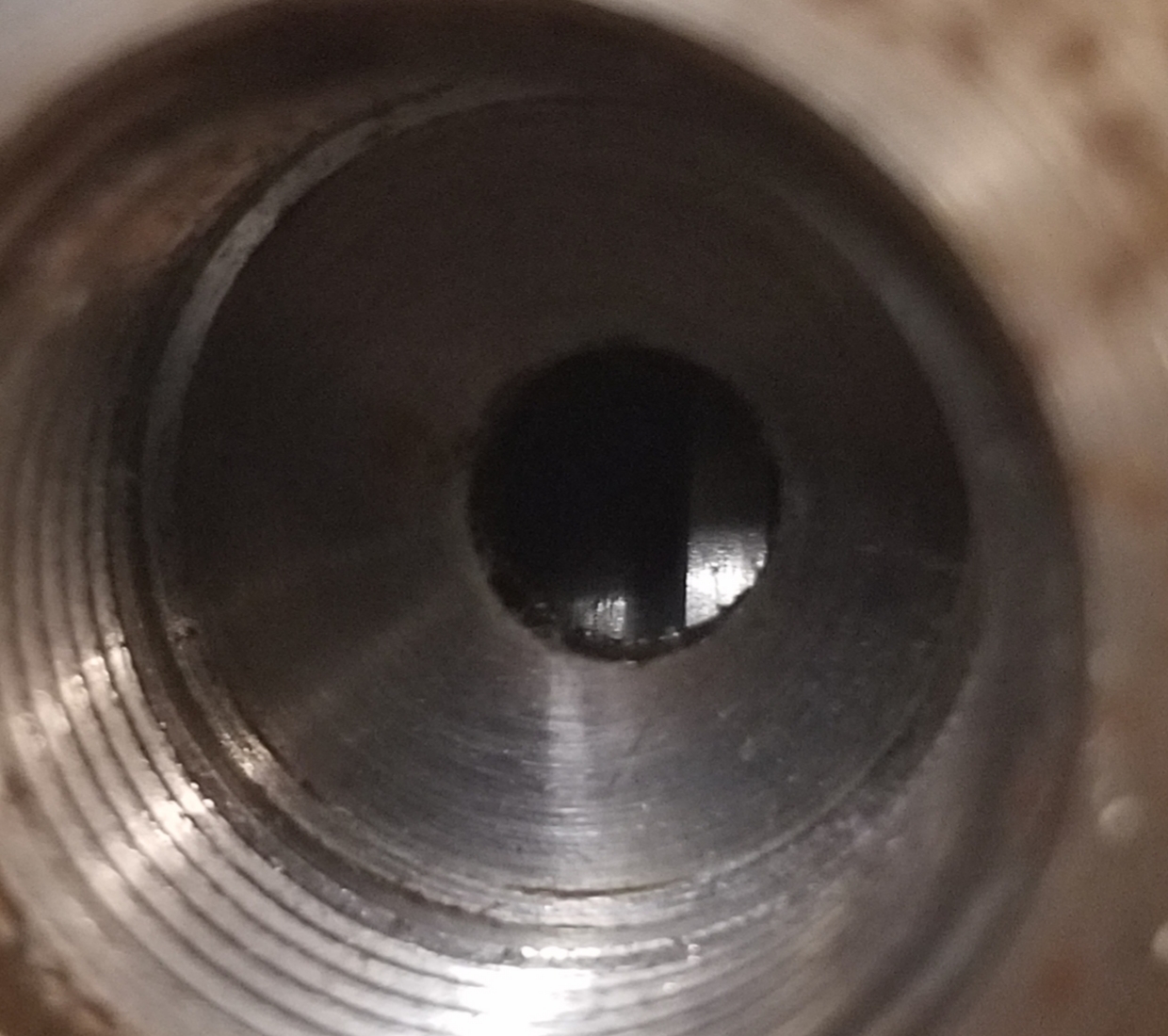

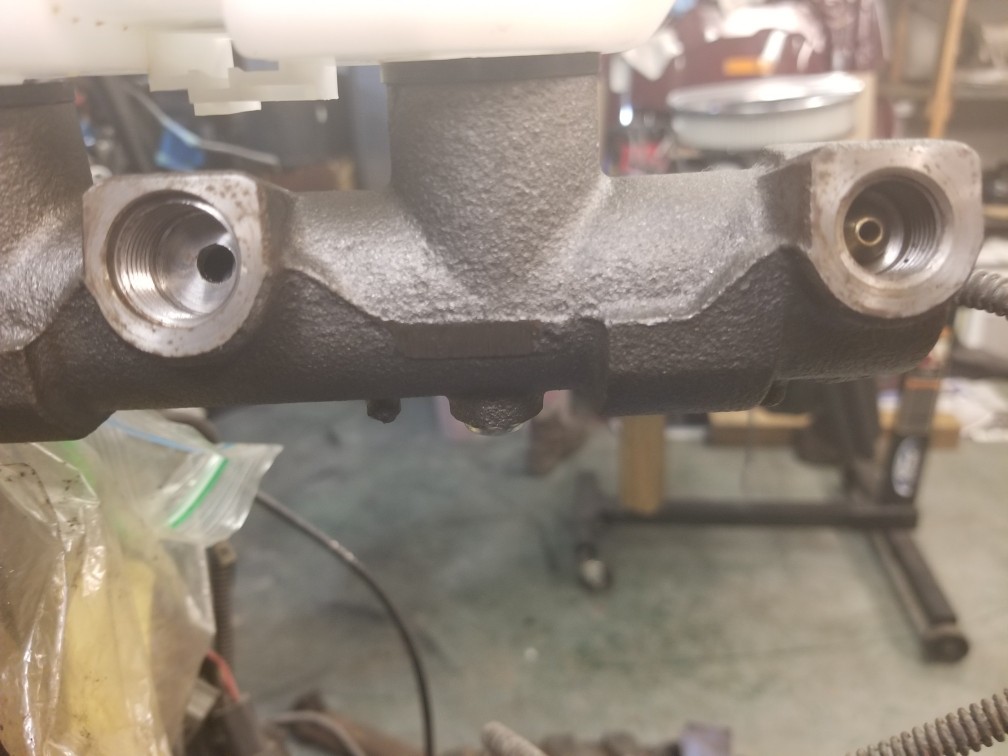

Does anyone have any idea what type of flare the port on the left uses??? I'm pretty sure it's a M12 and I'm getting a 1.5 thread pitch with my guage. But it almost looks like something is missing, theres just that hole and no seat for a flare to sit on. Call me crazy?

It's a remanufactured unit I bought a couple years ago...something tells me this isnt right.neither is the fact that I cant get the picture any SMALLER...having one of those days!!!

That's correct, maybe not for your truck, but it's right for something. The Explorer master in my Ranger is the same way. The port that you say looks "wrong" takes a bubble flare, not a double flare.
If you need it to take a double flared line get one of these bad boys from the local parts store with the right threads, and go to town.
I don't like using them just because it adds an extra joint that could potentially leak, and I have a master flare kit and can make either style on any sized line myself, but I have used them before without issue.
