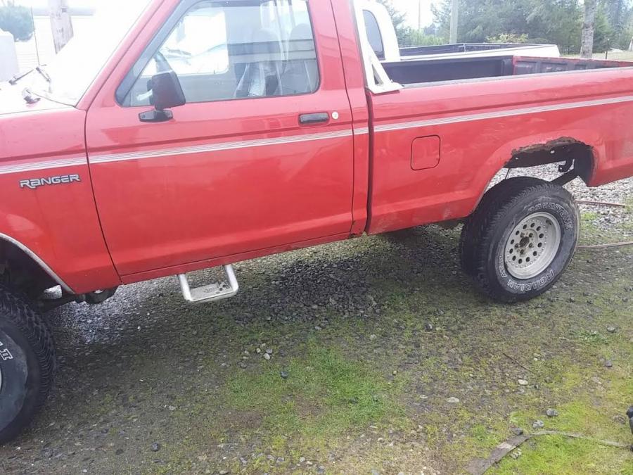

Ok, I have a unique situation. I currently own a 1992 Ford Ranger 4x4 Reg Cab Longbox with the 4.0 and 5 speed manual and has the 8.8 rear with d35 front, I LOVE IT!!!!!

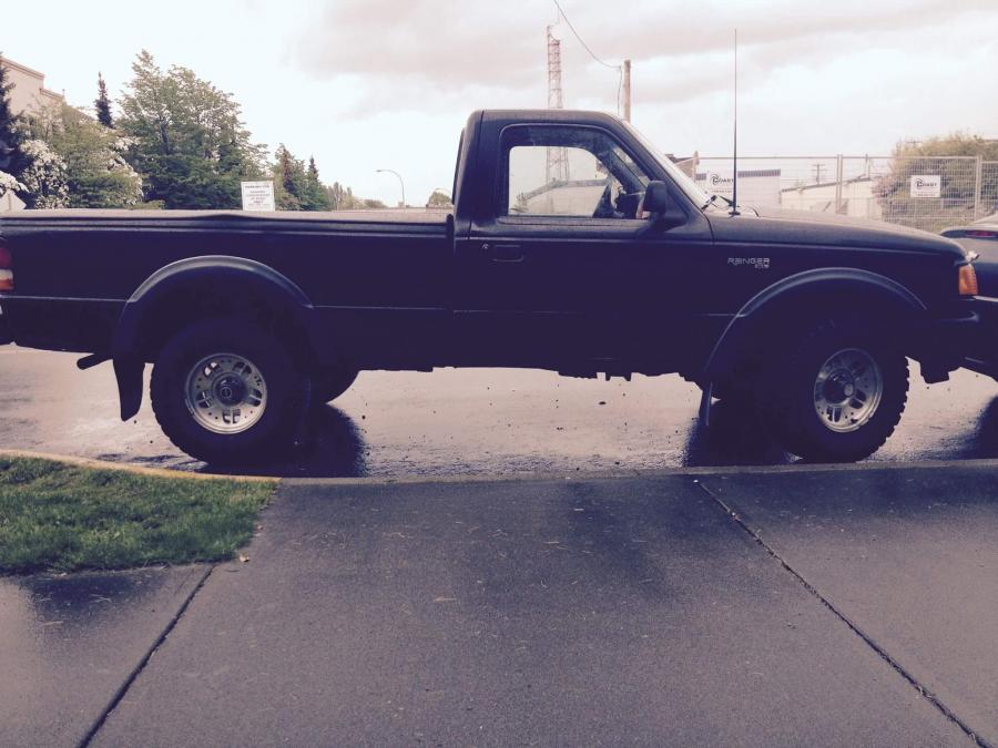

I also have a 1993 Ranger 4x4 Reg Cab Longbox with the 4.0 5 speed manual and has the 8.8 and d35 front, I like this truck also but prefer my square body MUCH MUCH more. I am only keeping one of them. My questions are to follow:

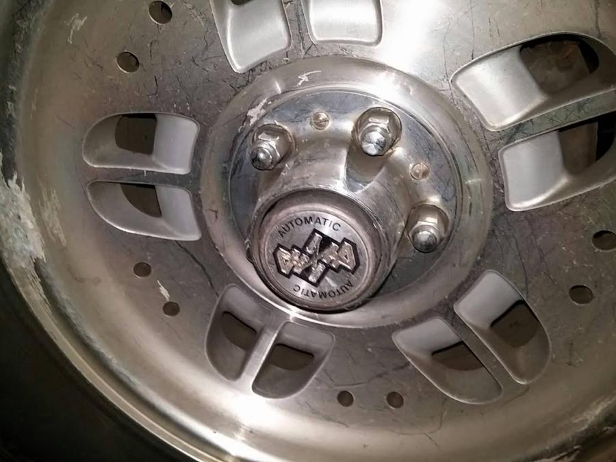

5. I want to take the rims off of the 1993 black truck and swap them with the ones on the red 1992, will the automatic locking hub thing in my picture somehow work with the aluminum rims pictured in the other pic?
