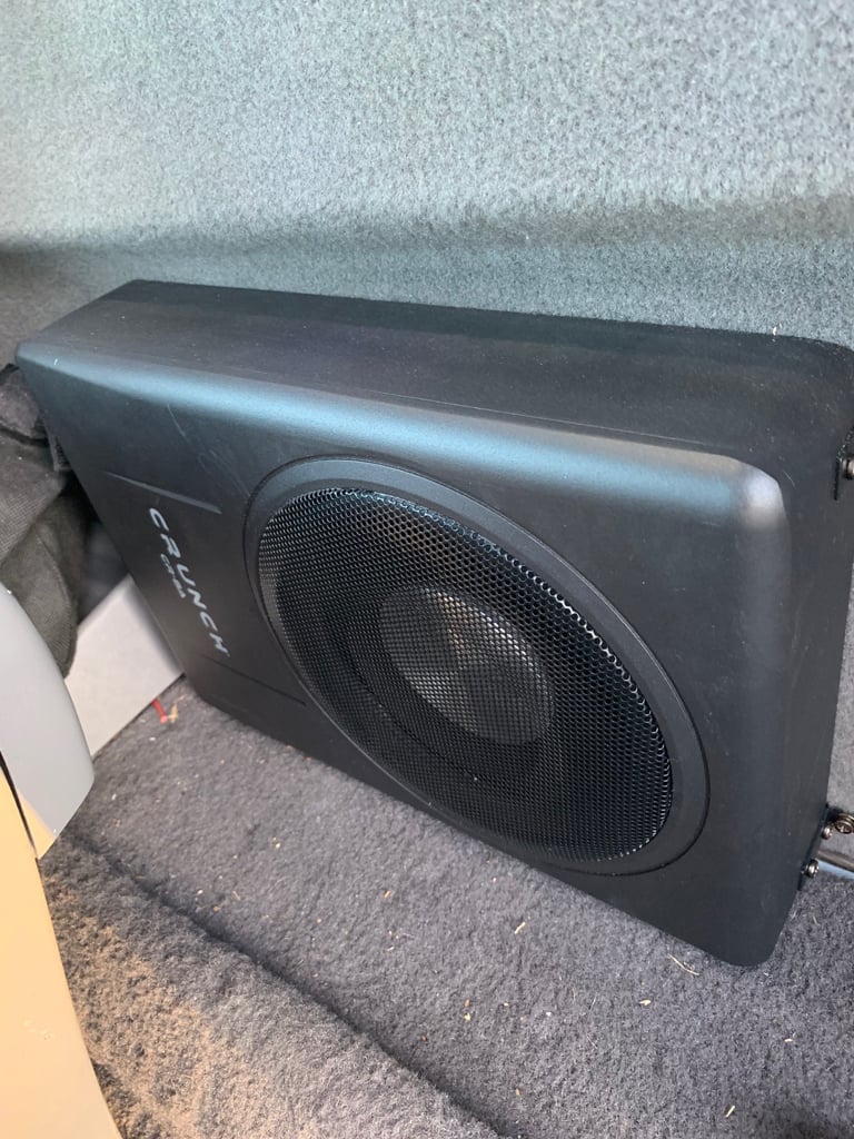

I ended up putting in a JVC-430BT double din radio in with a Bazooka sub and Rockford Fosgate speakers in the door. I hated that radio, sub, AND those speakers! They were mismatched, glitchy, and sounded like tin. Fast forward a while I now have a Pioneer AVH 500-EX with Skar 6x8 speakers and a Crunch 8” powered sub (CR-8A)
behind the seat. Sounds AMAZING!!!

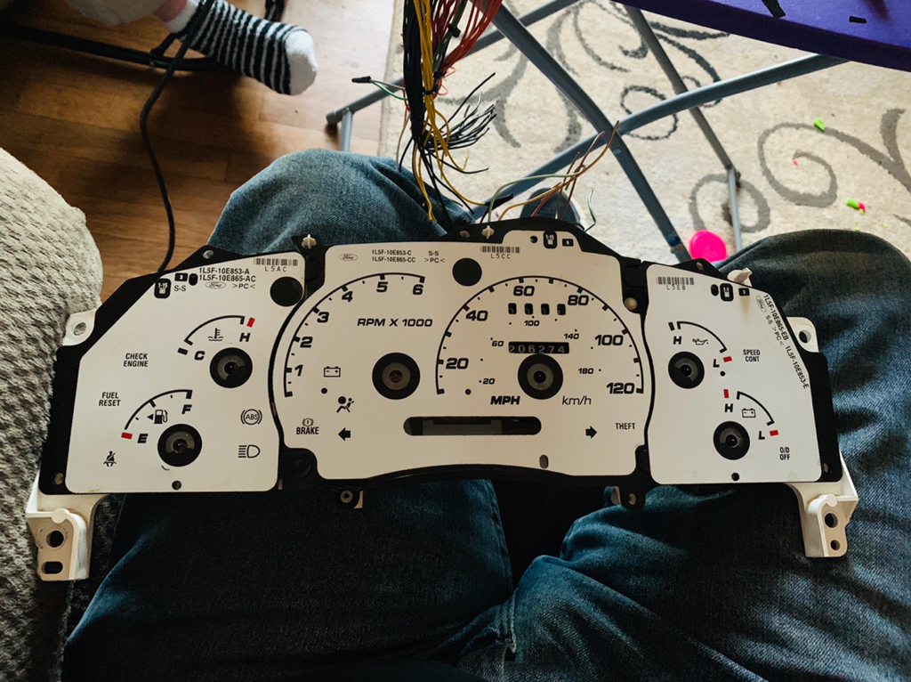

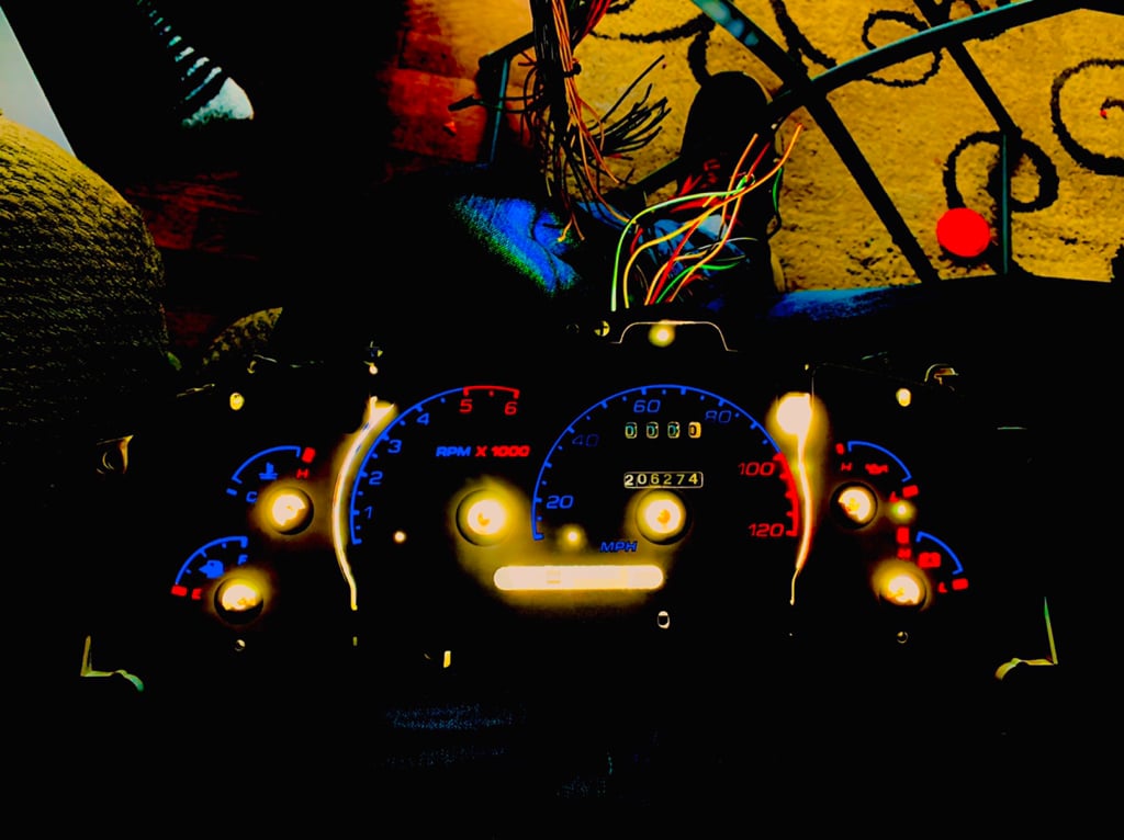

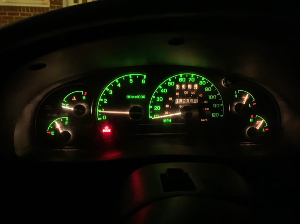

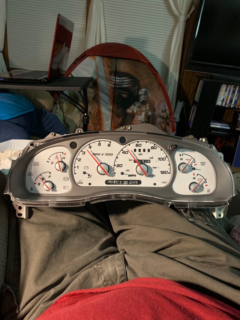

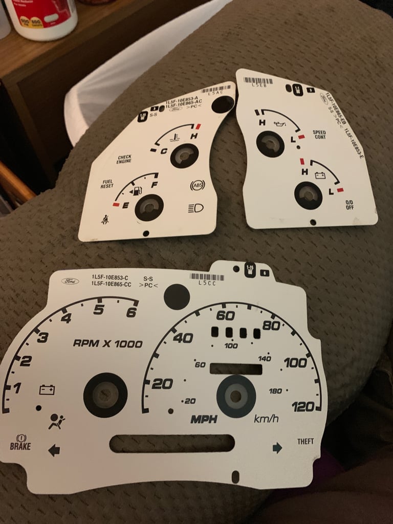

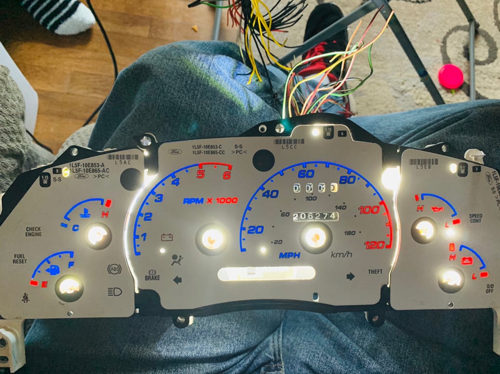

So I had ordered some LEDS from superbrightleds.com last week to use in converting the white sport trac cluster gauges to LEDS. I tried it once with my first Ranger, but had poor results. I’m the kind of guy that doesn’t do things halfway, poorly, or without a LOT of research. Doesn’t mean I don't mess up with all of that...I do.
Anyways... the LEDS came in today!!! I was super stoked to get them and get them installed. I had thought about light transmission, opaque vs transparent, white vs color...researched and listened to all the things people said about their conversions and began the planning. I decided that I wanted multi-colored opaque gauges similar to what is in newer more complicated gauge clusters. The light had to be bright AND able to penetrate the medium used to color the gauges. A BIG deal for me was to do it as cheaply as possible. I ended up buying one $0.25 opaque red plastic 2 pocket folder and one $0.25 opaque blue plastic folder from the Mart of Wal, and double sided tape (already had electrical tape and clear tape). I wanted the "danger" zones (tach and speedo) red and the rest of it blue. Idiot lights converted to LED and kept original colors. The pics are as follows:

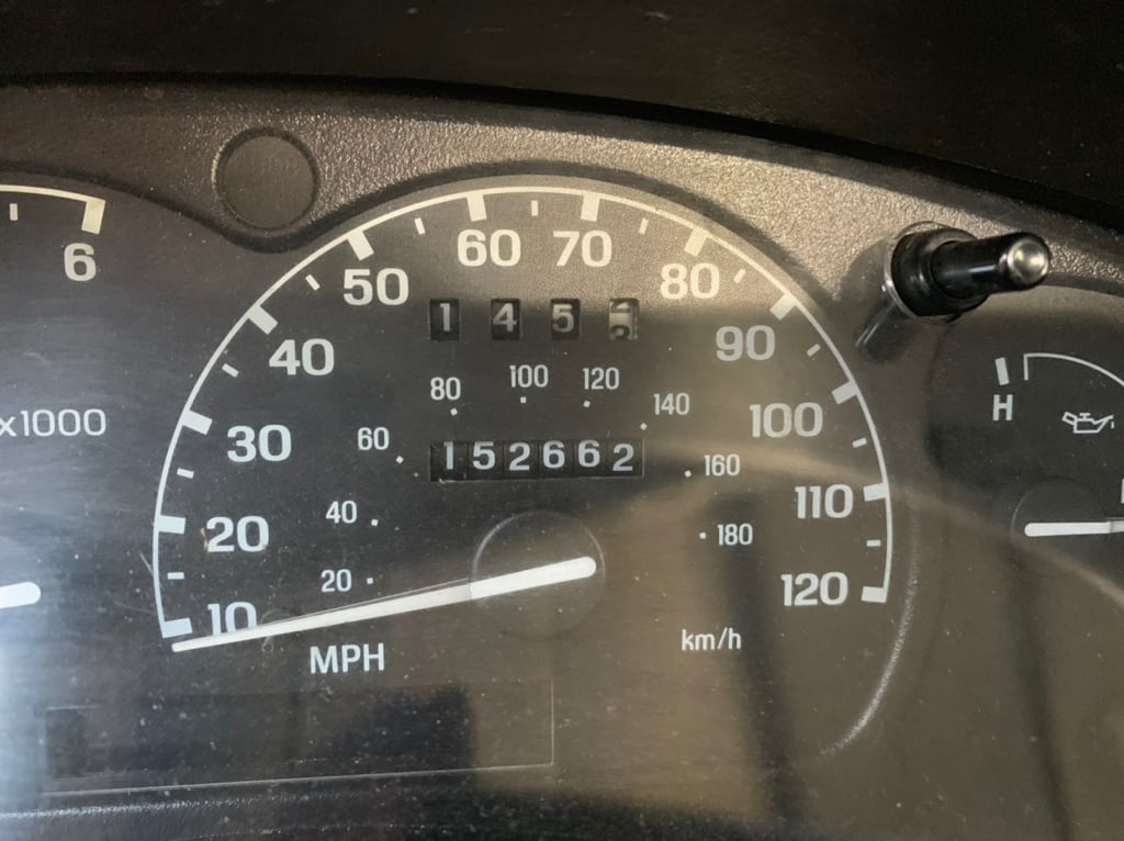

1:Original daytime
2:Original nighttime (yup...got a light out)
3:White face daytime
4: White face nighttime (closest approximation with manipulation of values) KM/H blacked out with electrical tape...Not important to me to see at night.
5: White face daytime lights on

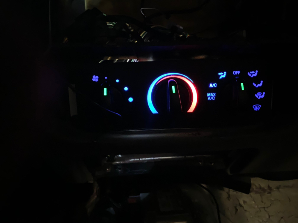

I think so far this has turned out great! :headbang: I'll get more pics once the cluster is installed. Going to do the HVAC controls as well in the same style. Just gotta figure out the HVAC knobs. Stinkin things are green plastic. Maybe I'll order some different ones. Any suggestions?
LEDS used: 6000k cool white 5SMD 194 bulbs, 74 LED bulbs (red, blue, green, and amber). All non CANBUS.

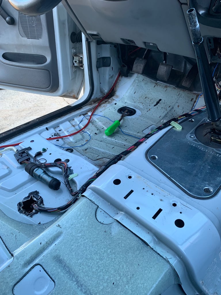

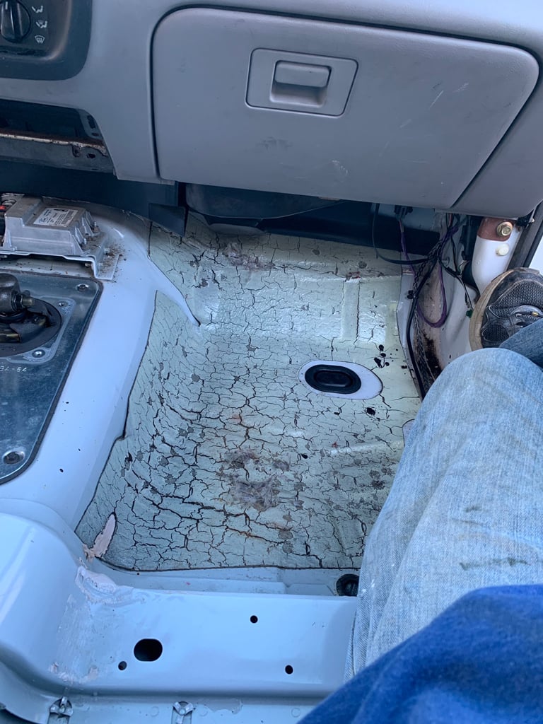

I live in upstate SC and we’ve had a LOT of rain here lately. I’ve noticed that my carpet on the driver’s side had been soaked through. I ended up pulling the carpet out because it started to smell like mildew. Here’s the current state of affairs...
In the first pic you can see the wire junction box thingy has been pushed through the floor pan. I think the problem with the cab having two body/floor plugs being rotted, and where the 2 plugs go there was bent metal. I think both problems led to my floors becoming soaked...that and all the puddles that splashed up.

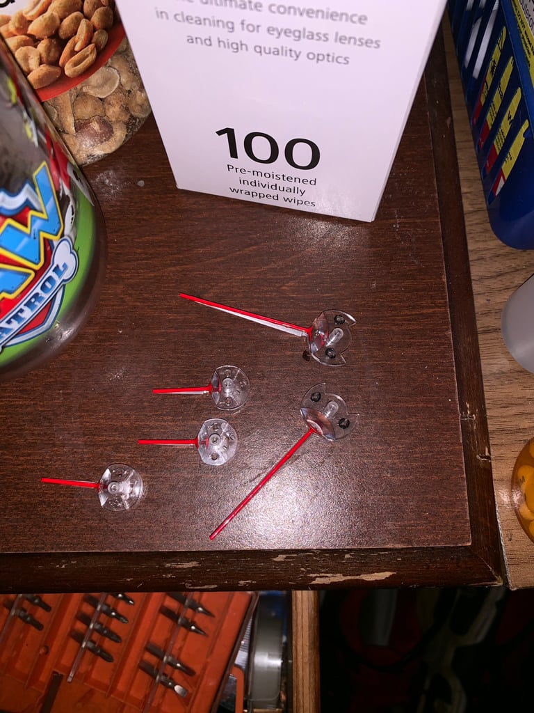

Been painting my stock gauge needles and needle center covers tonight. They used to be clear plastic with white on the centers and needles.
Now (hopefully) after they dry and I have the oopsie spots scraped off they will be red needles.
Materials used: Model Master Guards Red #4632, razor blade, and a 3/0 spotter paint brush
Here’s the original write up:
https://revlimiter.net/blog/2013/03/how-to-paint-gauge-needles/

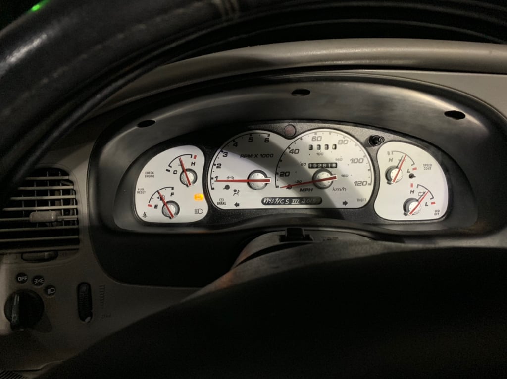

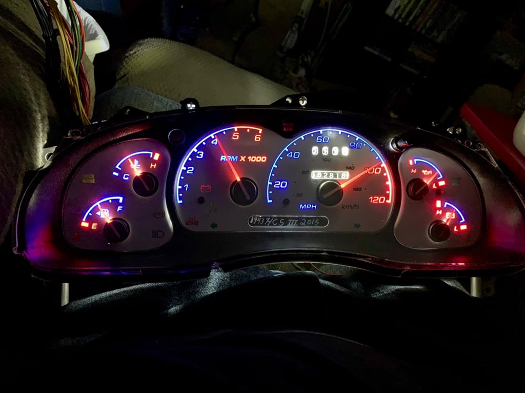

This is the final mock-up of the cluster. I’m pretty satisfied with how it turned out! It took getting parts from about 6 vehicles to get this result.

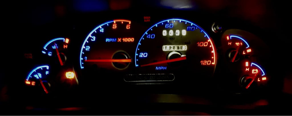

The camera really doesn’t help much, but here is a “night shot”.
