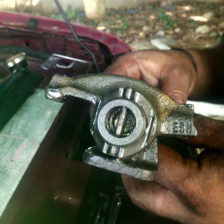

Hi bud, the truck is my dad's, he's in Venezuela, South America. Full 4 door in deed.Yeah, that looks for all the world like a rocker shaft assembly, but the 2002 should be SOHC, which wouldn't have those. More angles would be helpful.

First picture is the end of one bank's rocker assembly.
Complete assembly for both banks seen here: http://www.ebay.com/itm/PAIR-OF-ROCKER-ARM-SHAFTS-4-0L-V6-FORD-AEROSTAR-EXPLORER-RANGER-MAZDA-B4000-/361382530278?hash=item542413cce6:g:yVgAAOSwNSxVZxPj&vxp=mtr
He needs to replace the whole assembly on that side(bank) but the concern would also be why did it break to begin with??
Did the timing chain break or a hydro lock, i.e. valve couldn't be opened but rocker just kept pushing and broke.
At one time we had mechanics here that would REPAIR an engine or anything on a vehicle to get it back to work.From the looks of the one in the OP..the valve end appears to have been repaired/welded. Chances are someone tried to resurface the worn tip and caused more harm than good.
