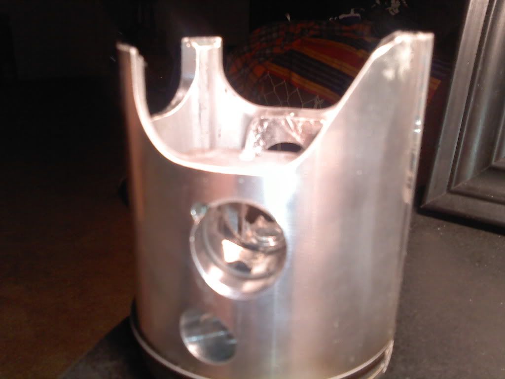

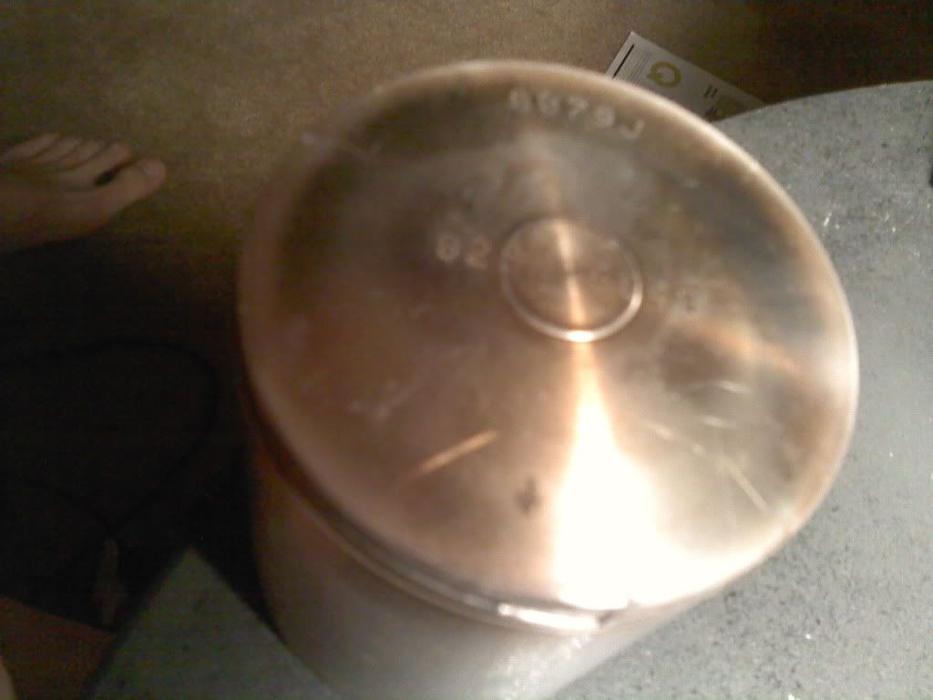

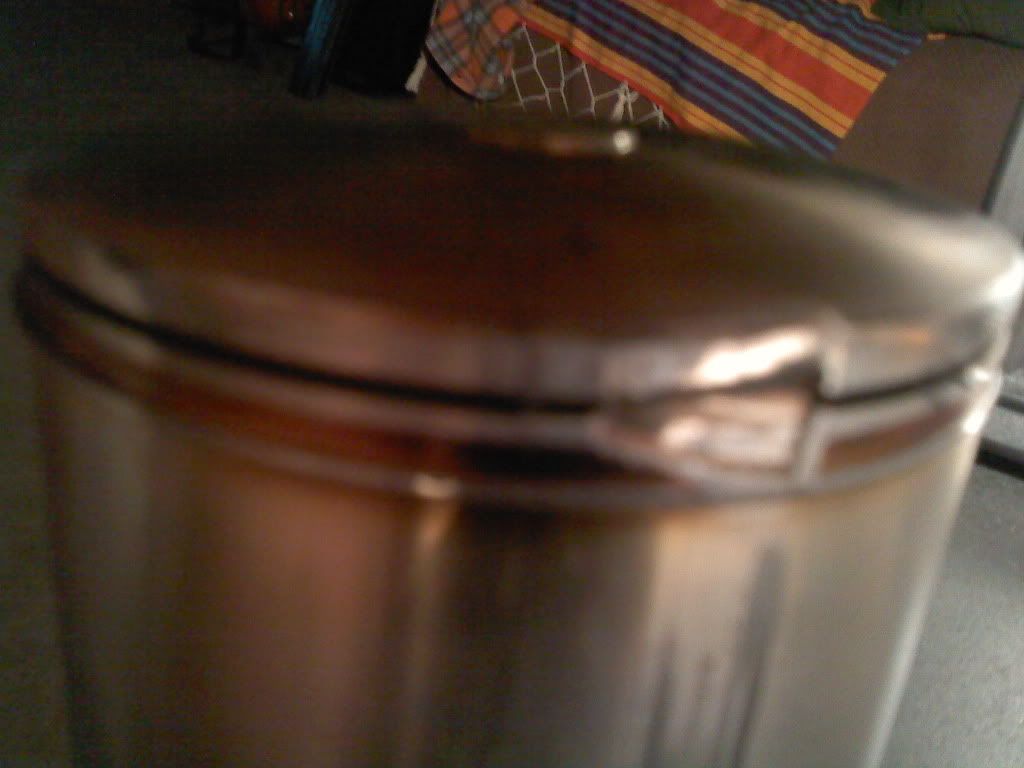

I had a cool idea for a new shift knob. Had this old junk piston laying around from my RM250. For some reason, it decided to break a ring on a fresh top-end, screwing up the piston, part of the exhaust/power valve, and the cylinder.

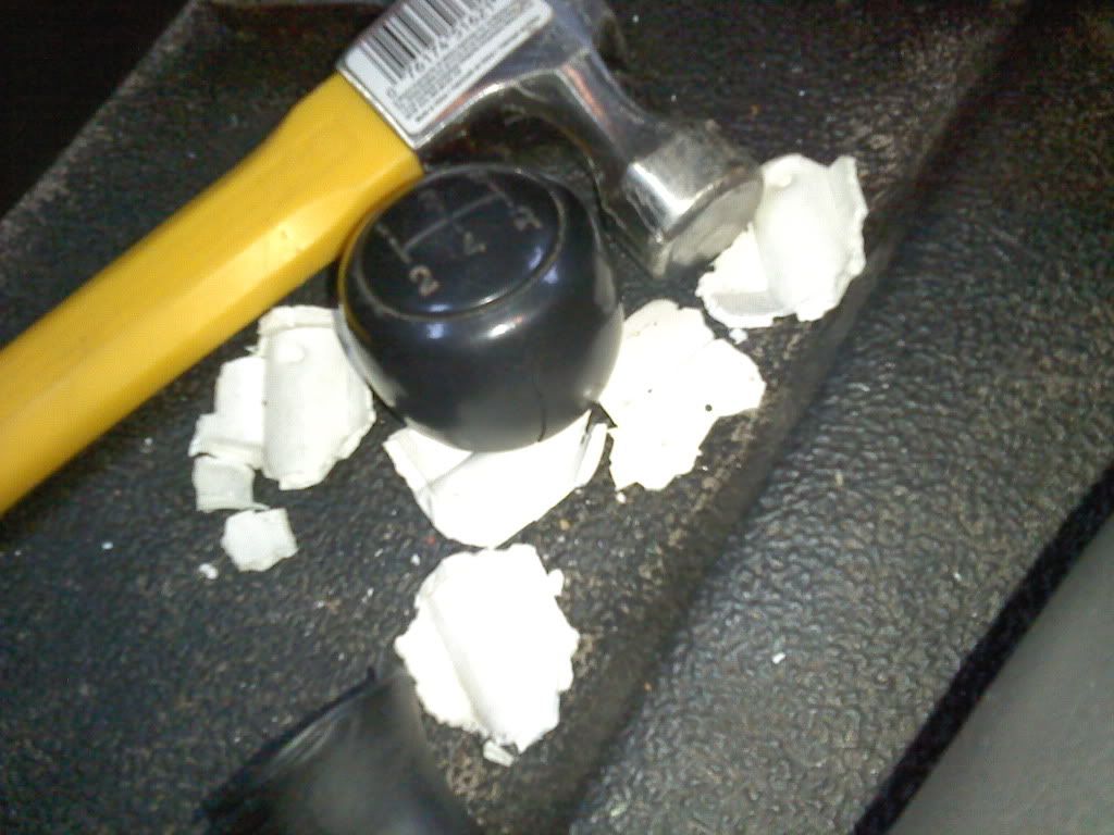

So I started removing the old knob. I read that all you had to do was pull, but this thing was STUCK. If Ford made other parts as substantial as they make their shift knobs, they'd have even tougher trucks. I resorted to cutting/breaking/grinding the old one off.
The rubber cap and plastic that was behind it.

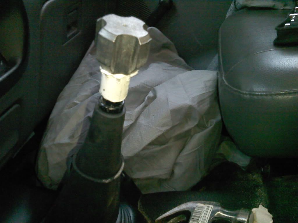

The core of the knob. I was trying to grind it down, and the heat from the grinder on it finally released the glue so I could pull it off.

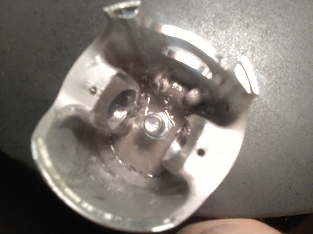

I JB welded a bolt to the inside of the piston, and the bolt fits in the end of the shifter. It's not a real tight fit, and there's not enough meat around the hole to tap it, so I'll just glue it in.
Sorta copied adsm08's idea. I'll install it tomorrow when the JB weld has fully cured.

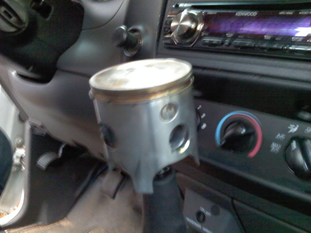

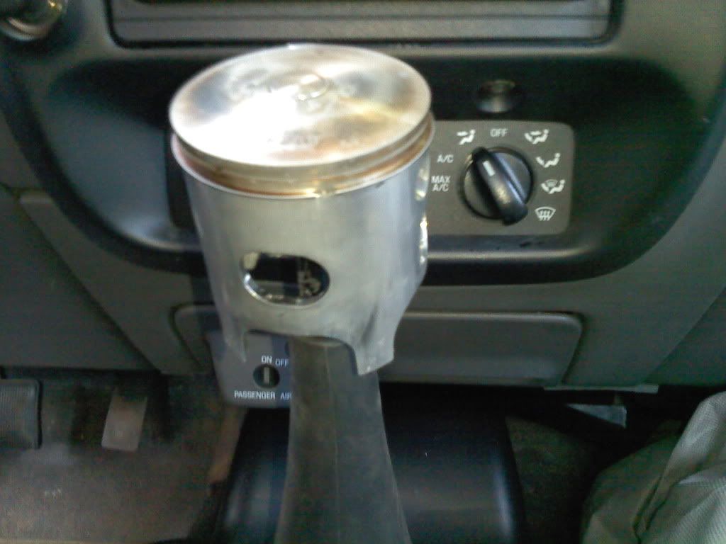

And here it is installed. Fits in my hand pretty well, and its quite comfy. Sorry for the low-quality cell phone pics.

Nice idea man, i like it a lot

I like that shifter idea...might have to look into that myself
