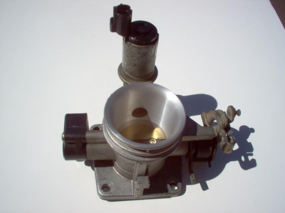

I was in the U-Pull the other day with a buddy and started poking around to see what goodies were worth picking up. I'd heard that different throttle bodies will work on the 3.0 vulcan and a common I've read was a duratec throttle body on a composite intake. I found ONE taurus new enough to have a composite intake, but it was damaged, and I found a couple duratec throttle bodies. However, the composite intake and the intakes on taurus's in general it seems have the IAC on the intake whereas the ranger intake seems to have it on the throttle body itself. So I get home and lo and behold it wont work for me. I kick myself because i had found a older 5.0 lincoln with a throttle body that WOULDVE worked but i left it there because it didnt have the idle passage. Ive skimmed the TRS forums but havent found much on throttle body swaps but was wondering if anyone out there has done it on this site.
What I have looks like this:
And what I came home with looks like this:
I am pretty sure certain 3.8's will swap as well but wanted to see if anyone had experience with this mod since just buying an aftermarket one seems a bit pricey. The info out there seems kinda slim (http://rogueperformance.com/UpperIntakeManifold.html#c). Thanks.

I have a 2000 Ranger with a 3.0 vulcan. My throttle body looks like yours. I had mine bored out by Proflow Design in Renton Washington. I actually had them source one for me and had it bored out to about 52mm (I actually sent them the very picture you have, I got it from the Morana site) because I didn't want to be without my truck for long. I'm very happy with the results, they tell me that the boring increased air flow by about 23%. I see more power, better throttle response, higher mileage, better acceleration, etc. No fitment problems, no alterations, just bolt it on and go! Hope this helps.

I know when i looked, I was actually kinda surprised how small the throttle body actually is compared to the intake hose and the intake itself. Do you recall what it cost to get yours bored and a link? I may go this route if it means I don't need to leave the truck sitting without a throttle body while its being shipped out to be bored...

Everything I've read seems to indicate the 3.0 is a revver and so it sems like common sense to help it breathe a little better. I do have a larger cat-back and a flowmaster so thats helped, and I do someday want to get headers, but its on an "as I can afford it" basis:rolleyes:. I firmly believe in the long run I'd rather keep my 3.0 than do any sort of swap. If I could get a throttle body that bolts on inexpensively, then hooray for me. The throttle body on a vulcan literally fits INSIDE of a duratech throttle body, and I picked it up for about $11. I know a 3.8 will bolt right up but the throttle cable connects to the opposite side. Some of these re-bores cost hundreds of dollars but a junkyard TB is a LOT cheaper and theres likely to be something that bolts up AND has the IAC motor on it instead fo the upper intake.

I guess i just can't wrap my head around the fact that a comparable sized motor ( duratec 2.5's in contours, 3.0 duratec's in taurus's, the 3.3 in a dodge intrepid) all have such noticeably bigger throttle bodies and such if the cylinder is only a given size.:dunno: I understand the principle of what you're saying, but i think that the throttle is a fair bit smaller than it ought to be. Of course I haven't cracked mine off to see how thick the casting for the upper is, but im sure a TB could be a bit bigger before its pointless.
Best illustration I can find is this link:
http://www.cardomain.com/ride/333436/1995-ford-ranger-regular-cab-tacoma-wa-us?p=4
The tricky part is that rangers have the IAC on the TB instead of the intake, and many sites that extoll the virtues of such a swap walk thru how to do it with a composite intake, which has the IAC on the upper intake. So either I'm sorta venturing into unknow territiry (I have the stock 1999 intake) or I'd have to swap to a composite which I've heard pros and cons about as well, so I'm sorta reaching out to see what others have done. The more I think about it, the more I think a 3.8 might work even though the throttle linkage and TPS are flipped but the pull is the same direction....
