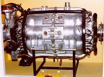

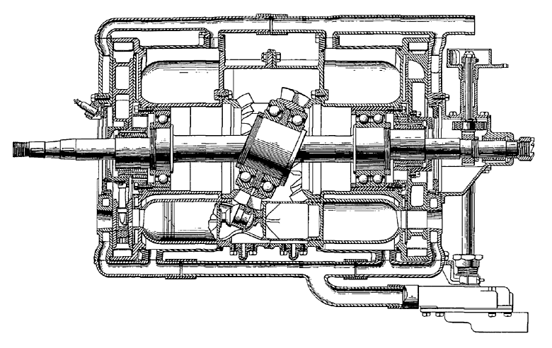

THE ALMEN A-4 WOBBLE-PLATE ENGINE: 1921
Left: The Almen aero engine: 1921
Eighteen horizontally-opposed cylinders in two sets of nine with a central wobble-plate; static barrel type. Water cooled. Rotary valve disc at each end of the engine.
The A-4 was the fourth experimental barrel engine built by John O Almen of Seattle, Washington State, for testing at McCook Field, Ohio. The engine project began in 1921 and by the mid-1920s, the A-4 had passed its acceptance tests. Despite this success the Almen engine never went into production, because of a growing emphasis by the US Army Air Corps on air-cooled radial engines with large frontal area. European air forces generally preferred water cooled engines.
Like other barrel engines, the Almen had a much smaller frontal area than other water-cooled engines of similar horsepower, promising reduced air resistance when installed in an aeroplane. It was rated at 425 hp but weighed only 749 pounds (a power/weight ratio of 1.76 lb/hp), a significant achievement for the time.
This example is in The National Museum of the USAF at Dayton, Ohio.
This shows the other side of the engine. The propellor mounting flanges are on the left, and the dual distributors to the right. Dual ignition was fitted, calling for 36 spark plugs.
Photograph by kind permission of Phil Callihan. See his remarkable website at http://airpower.callihan.cc/default.htm
Left: The internals of the Almen engine
Below the crankshaft is a sectioned cylinder containing one of the double-ended pistons. The cooling water pump is at bottom right.
Bore4.25 in
Stroke5.5 in
Displacement1404 in3 (23,007 cc)
Output425 HP at 2000rpm
Weight749 lb
Diameter20in
The vital statistics of the Almen engine

That's a really cool mechanism. The sliding components at the head disqualify that engine for me though.
