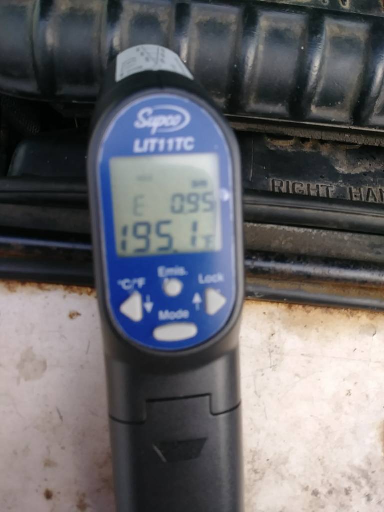

Went outside with my infrared handheld thermometer. It's in the high 50s outside.
Engine fan runs like it's locked at any speed even though you can turn it by hand when it's not running, sounds like a Jeep! Which is the sound my other truck makes with the heavy duty fan clutch, until it warms up!
After running a good half hour the heater hoses barely made it to 160 the upper radiator hose and thermostat never even close to 180!
Engine is not warming up! of this there is no mistake!

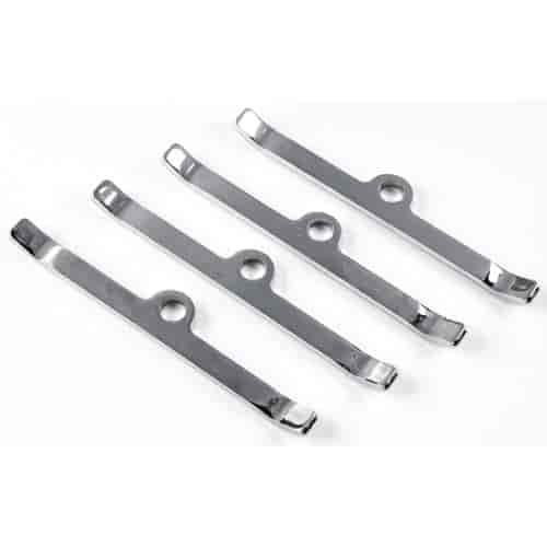

valve covers are leaking bad! who make these for the 4.0?

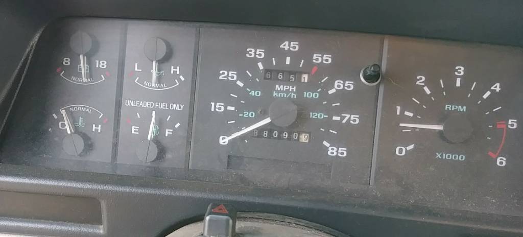

Why I think my temp sensor is suspect, making a running rich condition.
Pics show temp about when the 180* opened. My other truck's temp is much better with a 180* T-stat
