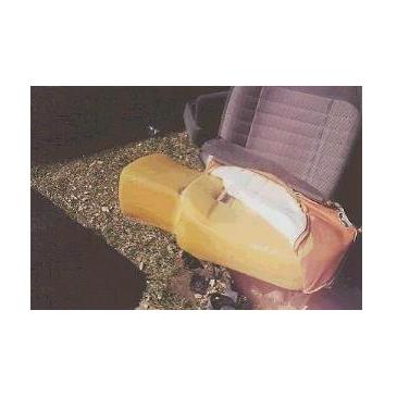

I'm replacing mine. If you want a 60/40
With no slides. Porno red split on drivers seat.
