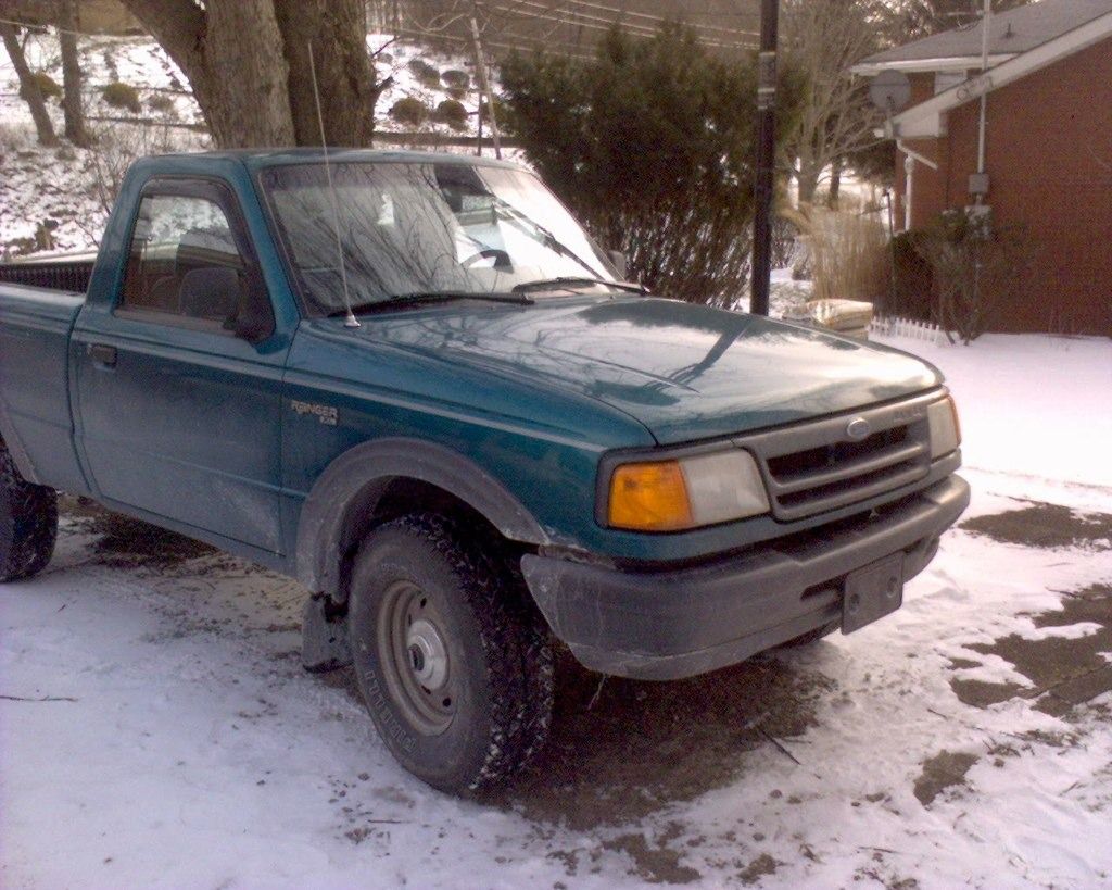

Well I have finely decided to start a build thread for my Ranger. I have been messing around with it since 2005 and now that I am out of college with a job thats lets me have a little fun, I have collected a whole mess of new parts.

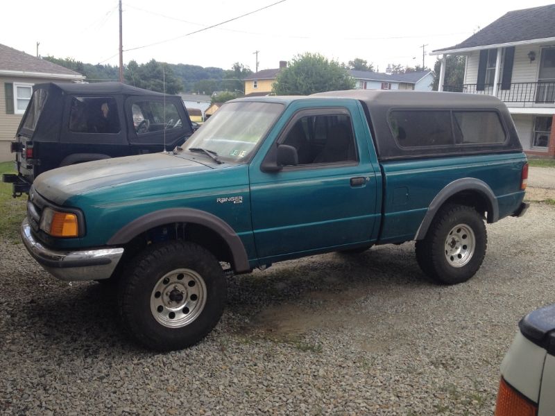

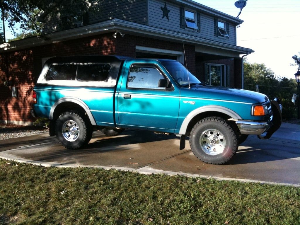

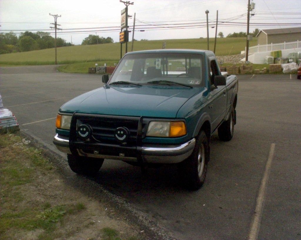

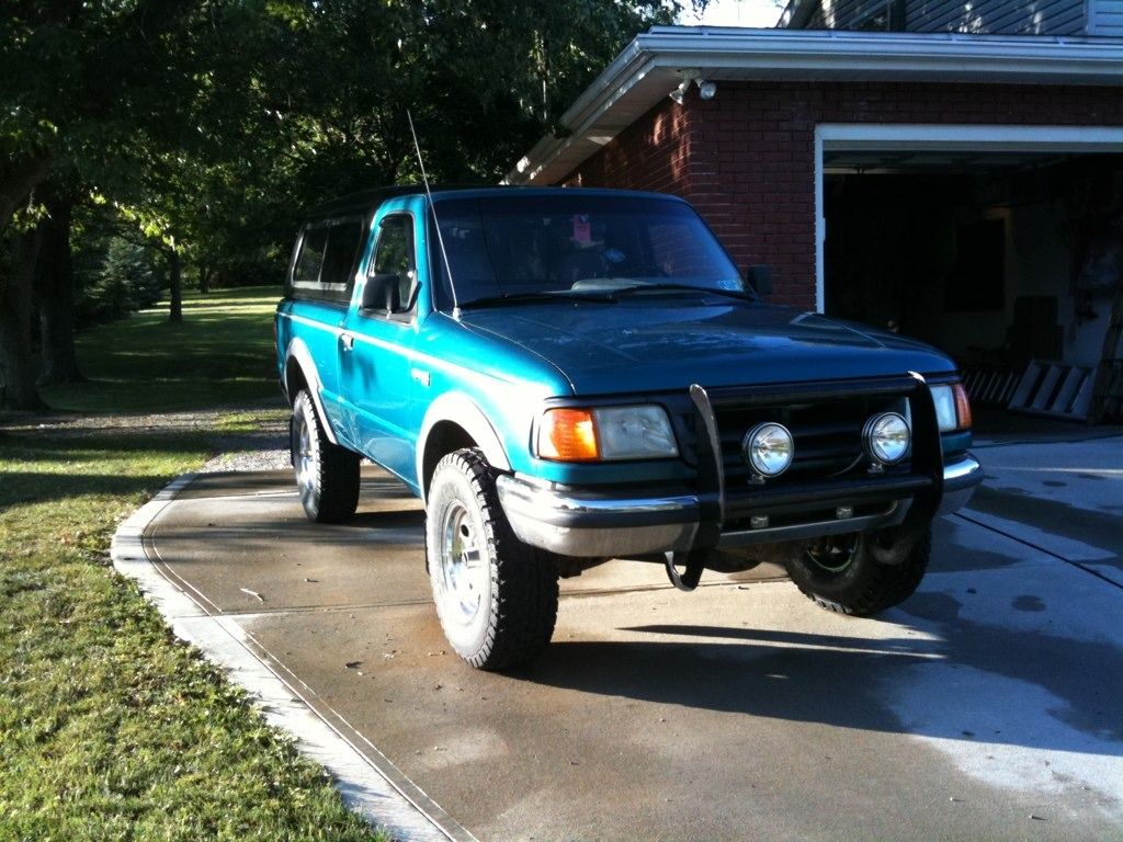

Here is the Ranger from the time I got is senior year until about a 2010.
28 Spline 8.8, Eaton Posi w/ 800lb springs, Ford Racing 4.10 Gears, Trick Flow Girdle - $250 on Craigslist
Sporting 31x11.5 TSLs on 15x8 Outlaw 2 Wheels
$50 Cap, 31x10.5 Uniroyal A/Ts, New Eagle Alloys 15x7

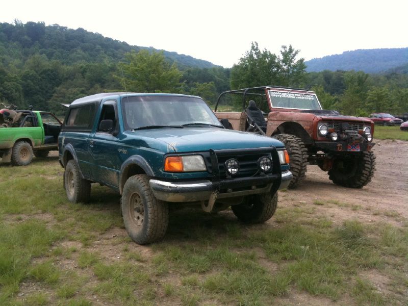

West Co Highlands with 1BadExplorer's Bronco

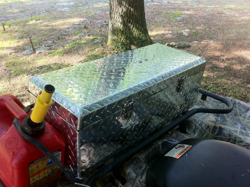

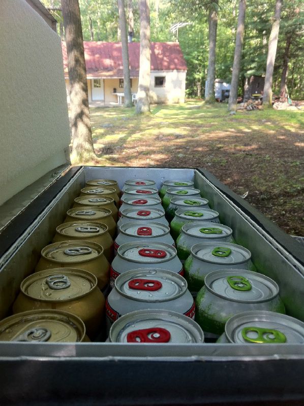

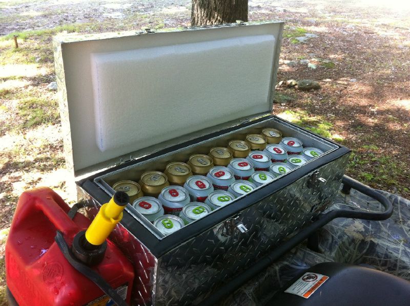

I built a cooler from a DeeZee aluminum toolbox and insulated it and added a an aluminum inner boxed that fits 24 pressurized cans like a glove.
Put a diamond plate bumper and bash plate on and added a big rear box to ride doubles:

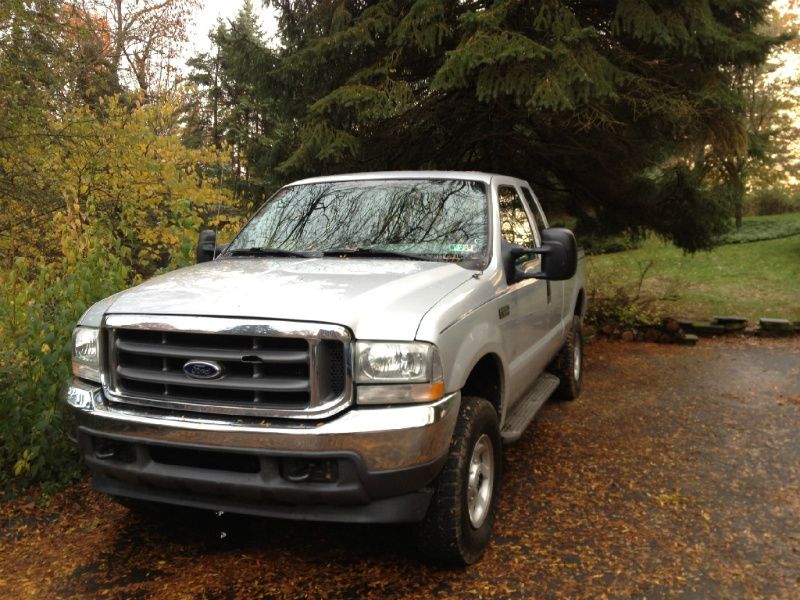

The Ranger wasn't happy about hauling the quad, and then I stumbled on this:
2004 F250 XL Extended Cab Short Bed
5.4L V8
5 Speed + Granny Low
Mechanical Shift 4x4
Manual Lockouts
Dana 60 Front w/ 4.10s
Sterling 10.5" w/ 4.10s L/S

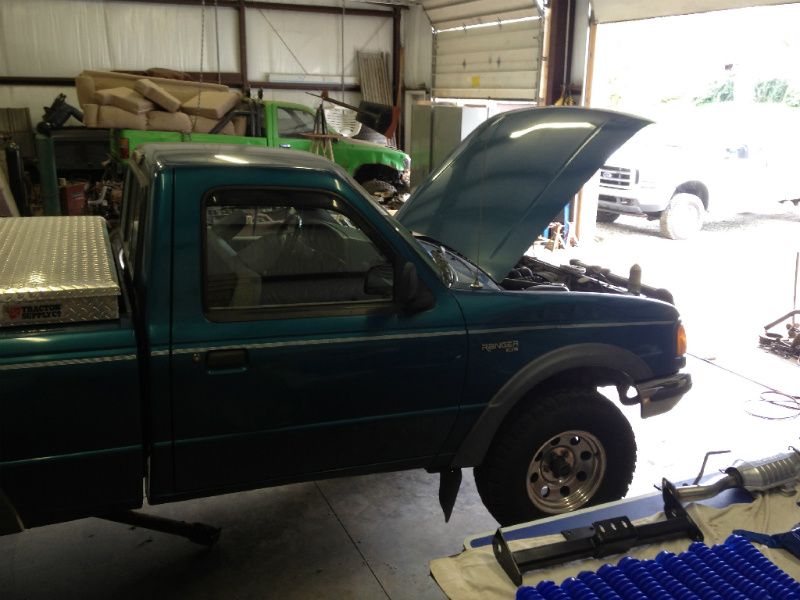

I am feeding this monster now as I work on the Ranger.
Now for the Ranger...

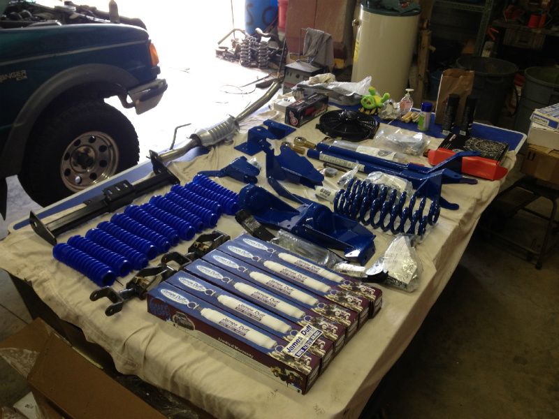

I already have:
James Duff 3" Stage 2 Lift, Axle Pivot Bushings, and Leaf Spring Bushings
Teraflex Revolver Shackles
New Zoom Clutch
A Tranny Rebuild (using AMSOIL from here out)
New Slave Cylinder
New Radiator Core Support
LMC Truck E-Fan, Controller, and Mounts
Magnaflow bolt on Cat
Cherrybomb Glasspack
Rest of the exhaust odds and ends
I still am going to order:
AutoGage Oil Pressure Gauge
AutoGage Vacuum Gauge
Autometer Pillar Pod thingy
As she sits now:
and the new parts:

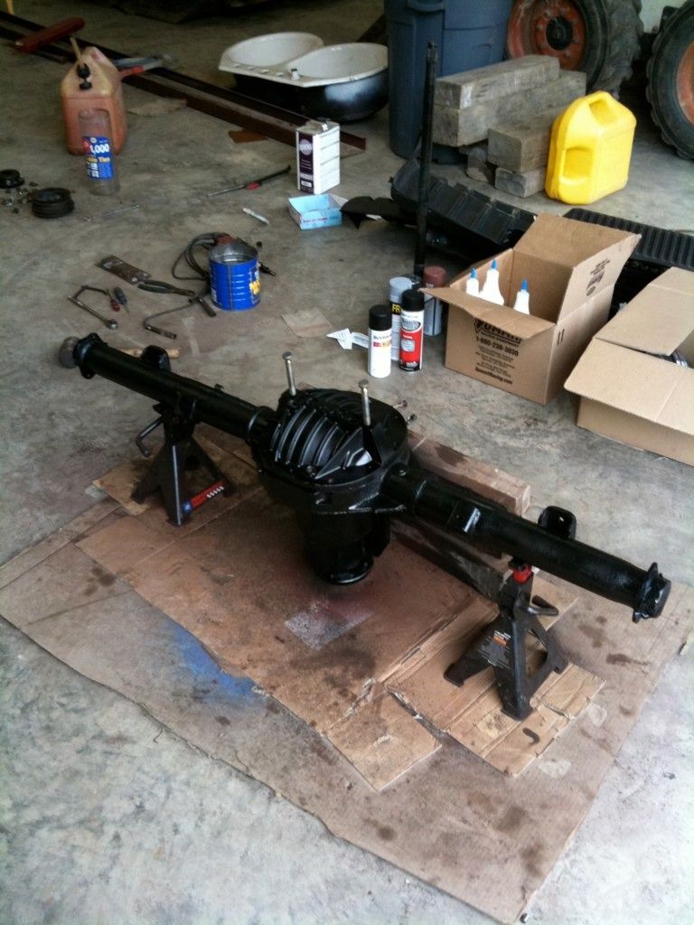

As of this past weekend I have the transmission completely rebuilt, and the rear end removed. I am cleaning and repainting the parts and undercarriage as I go, so it will probably take me a little while to get this done. I am also working on it an hour from where I live, so its mostly weekend work.

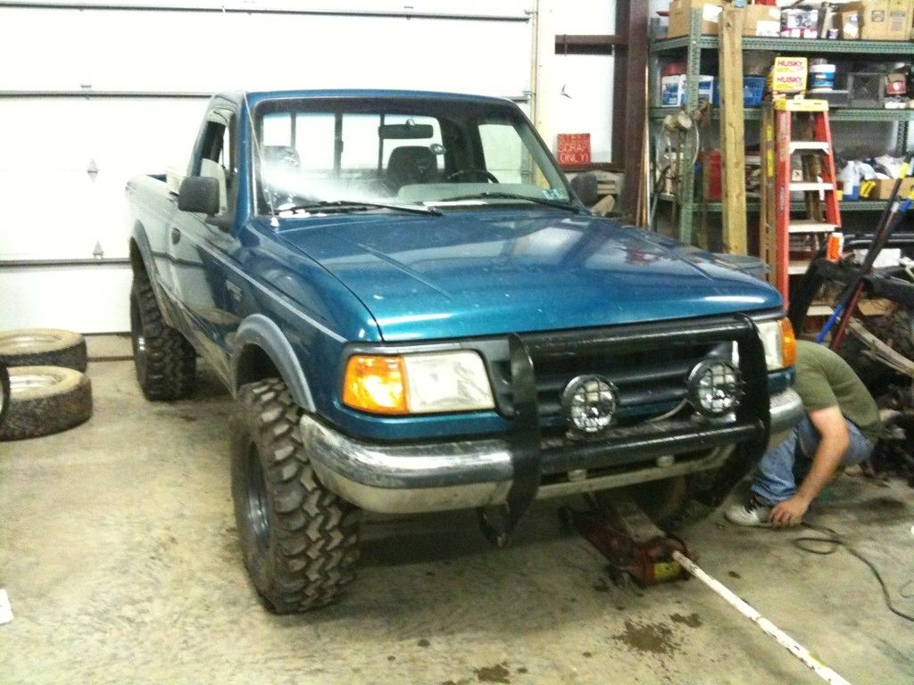

What are your plans for tires?
I still have the 31x11.5 Swamper TSLs pictured above. I just need to get one new 15x8 wheel. I had a bit of a problem with the one my buddy Joey is putting on in the picture. The whole wheel and tire fell off, turning my Ranger into a tripod.... at 3am! :annoyed:
It turns out, the bolt holes were worn and I was using the little wimpy lug nuts for the stock steel wheels. Oh well, lesson learned :icon_cheers:
