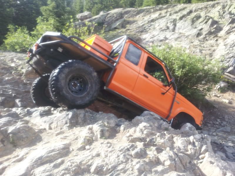

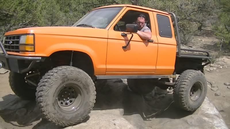

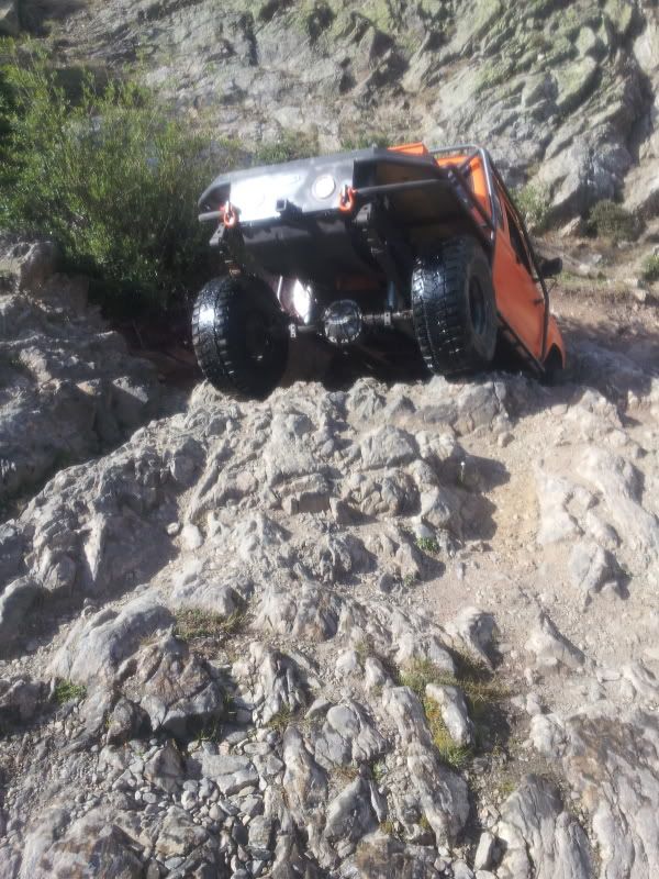

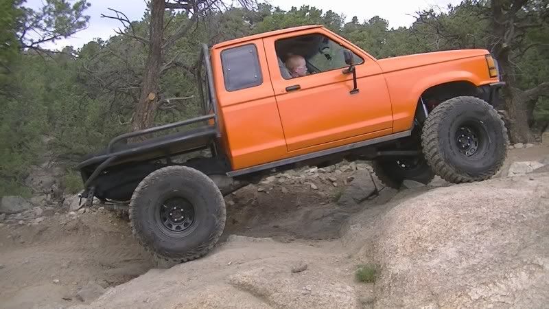

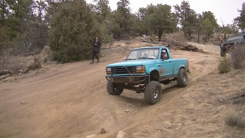

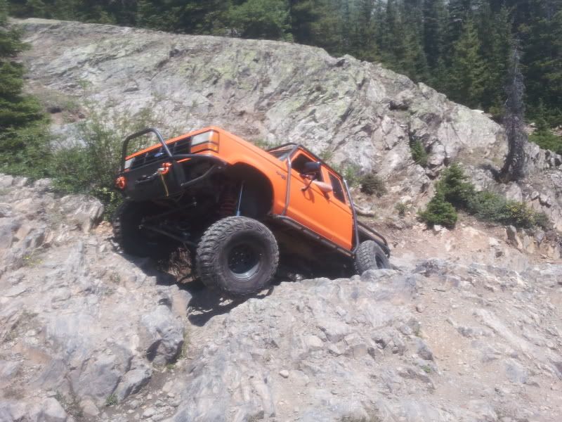

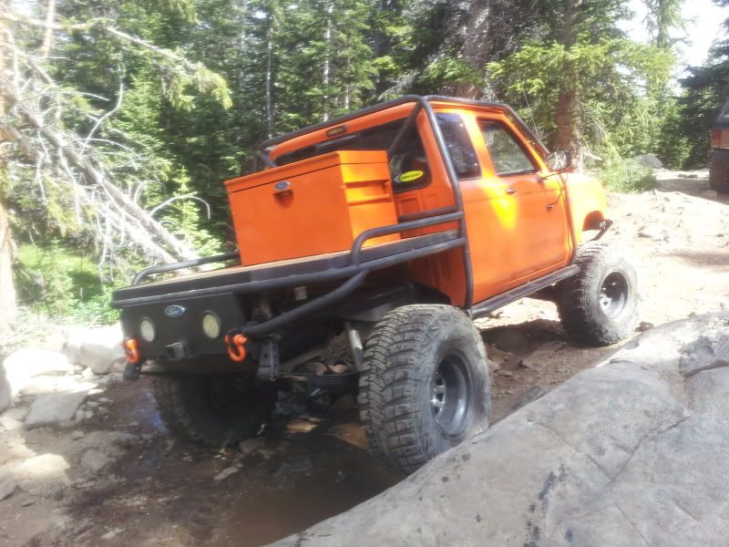

The first Ranger SAS was TNT here is pic...

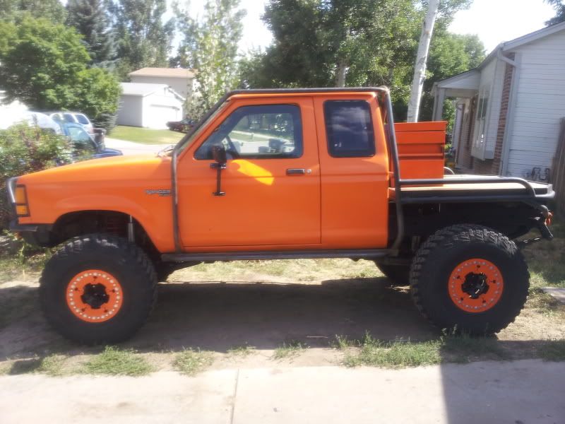

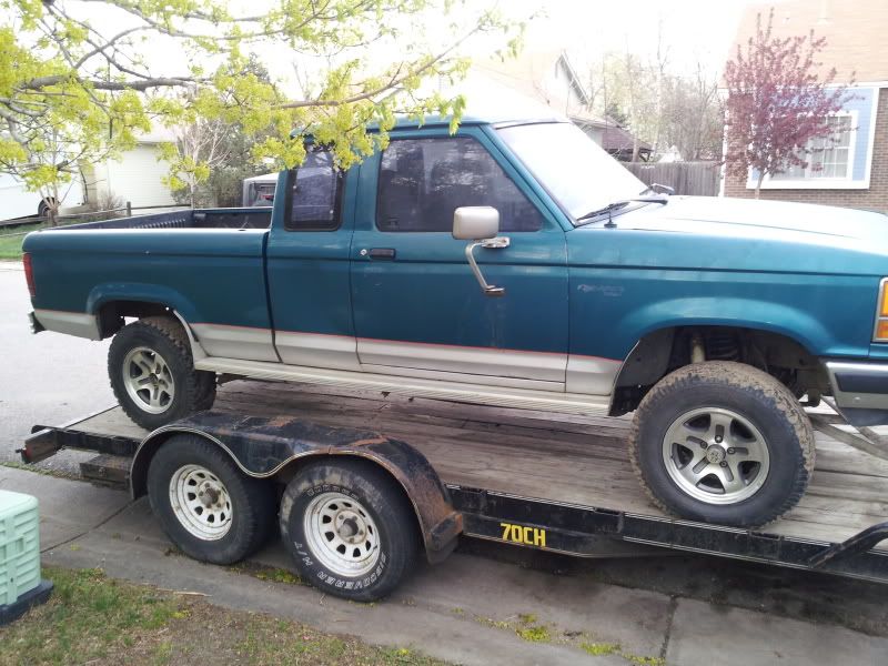

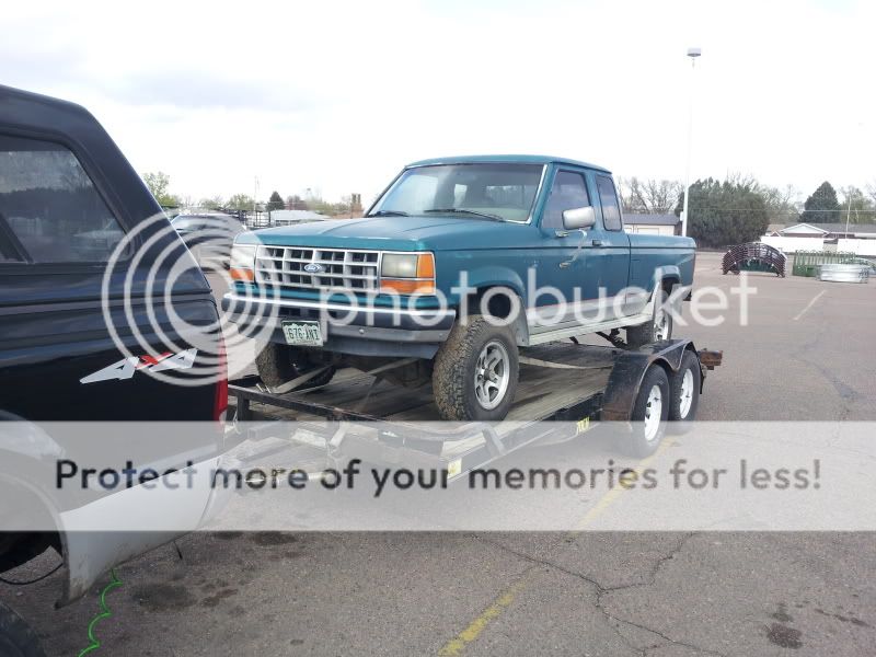

My new Ranger just picked up last Sunday the 15th 92 Ranger 4.0L 4x4 bad tranny picked it up for $750. Truck has 159k and pretty rust free just a few spots here and there. Code name Rock Ranger otherwise known as Double R.
Already sold the 8.8 and bed off it. I will be keeping this one pretty simple very similar to TNT.

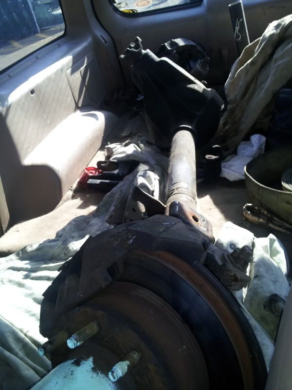

Did pick up a High Pinion Dana 60 4.10 front but I am going to save that for another project.
Here it is in the back of the Merc. I walked into the junk yard and a 95 F350 was just sitting there don't come across many of those so I jumped on it. Talked them into $200 bucks for it. :D

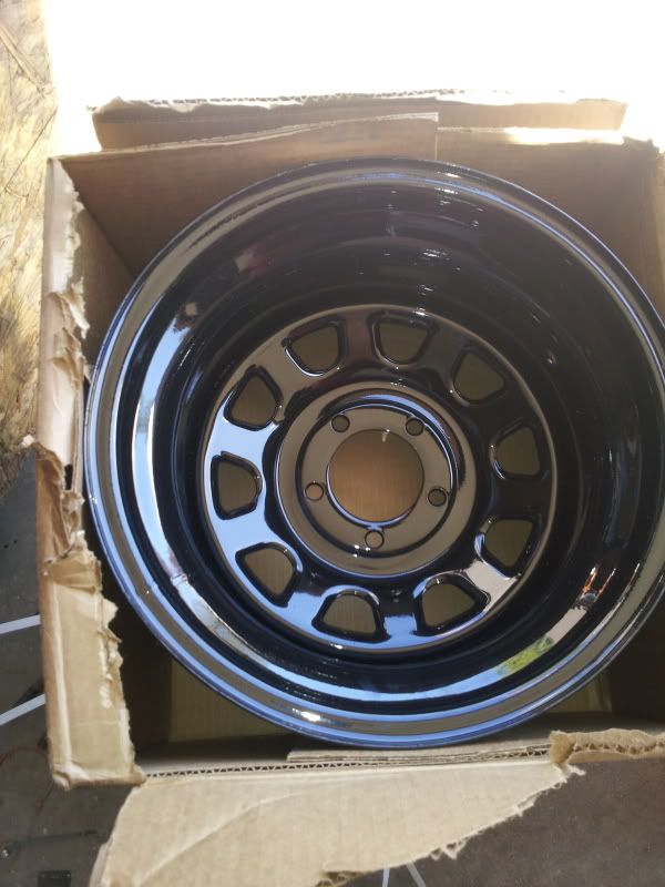

New 15x10 heavy gauge wheels showed Yesterday. Went with 4 inch back spacing. They were $223 for 4 shipped to my door from Summit. Trying to do decide what design to do for the beadlocks I need to order those soon.

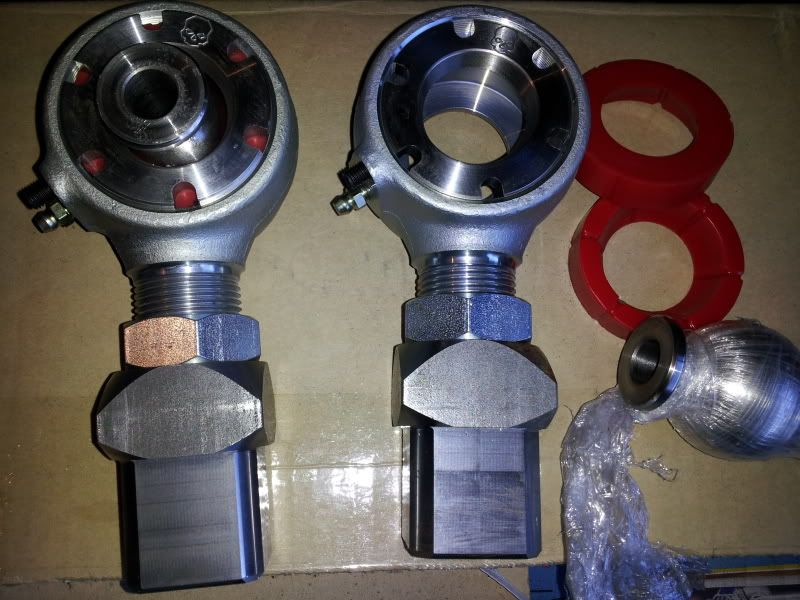

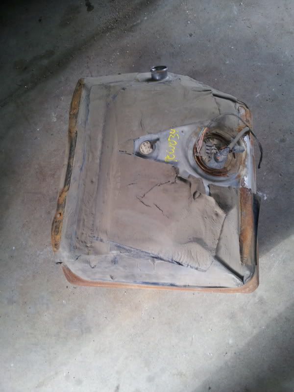

Got my new rod ends for the truck. They are super sexy! Hoping to have time this weekend to start on the truck. Also picked up some 64" Chevy leafs this morning. I grabbed a Bronco II tank get it all the way up to pay for it and guy is like you know we poke holes in those to drain them. I flip it over and was like EFF. Guy is like you still want it. I said Eff NO! He didn't have much to say after that. So still need to find a tank.

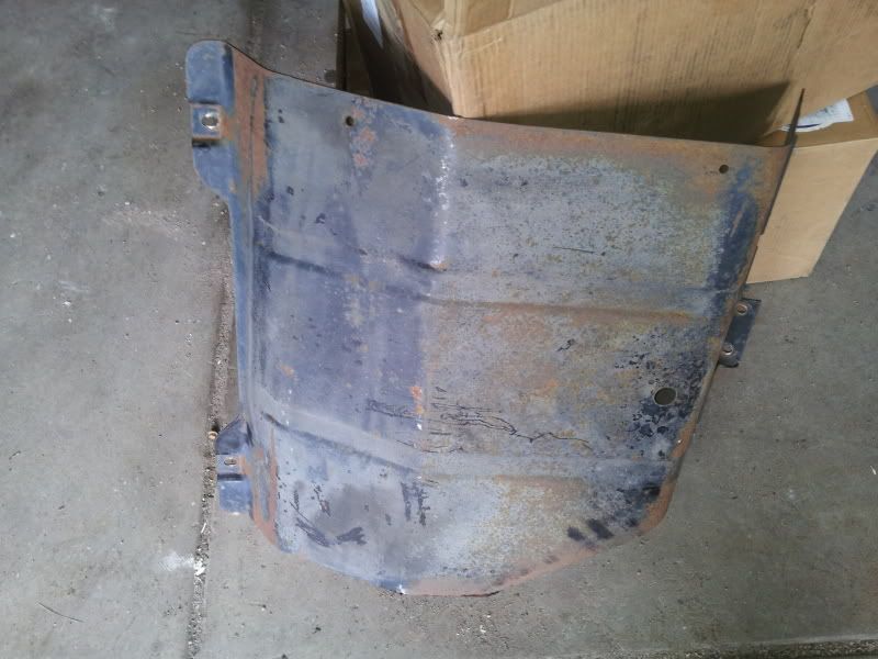

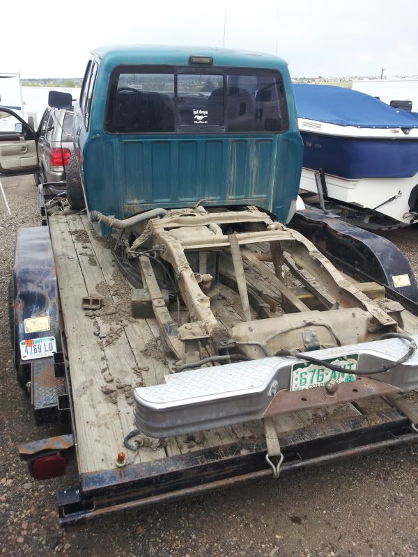

Picked up a Bronco II tank from a full service yard the guy gave me the factory skid plate too. Also sold the bed. I should be doing the rear axle this weekend and maybe some of the front depending on how it goes. Working on kitchen remodel for my wife so that has been taking up my free time.
BII gas tank with pick up.
BII skid.

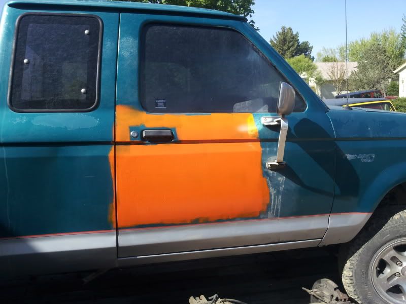

Now that the bed is gone I am getting pretty excited about starting.
This will be the paint color of the truck.
