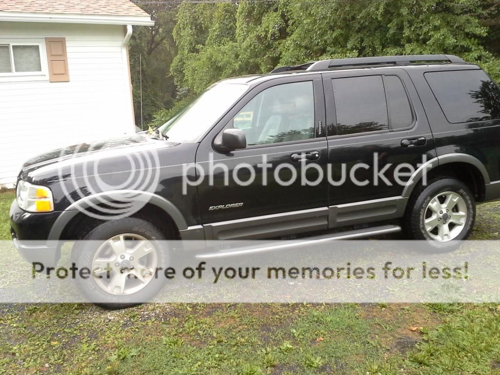

Alright, next build.

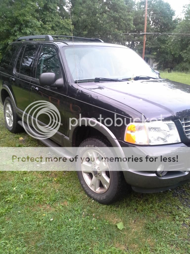

This is the wife's new-to-us 05 Explorer. She will replace the 2010 Escape, not that we want to get rid of the Escape, but we want to get rid of the car payment, we need something bigger, and the price was right.
A little hail damage on the passenger side, no big deal. It will need a new hood though.

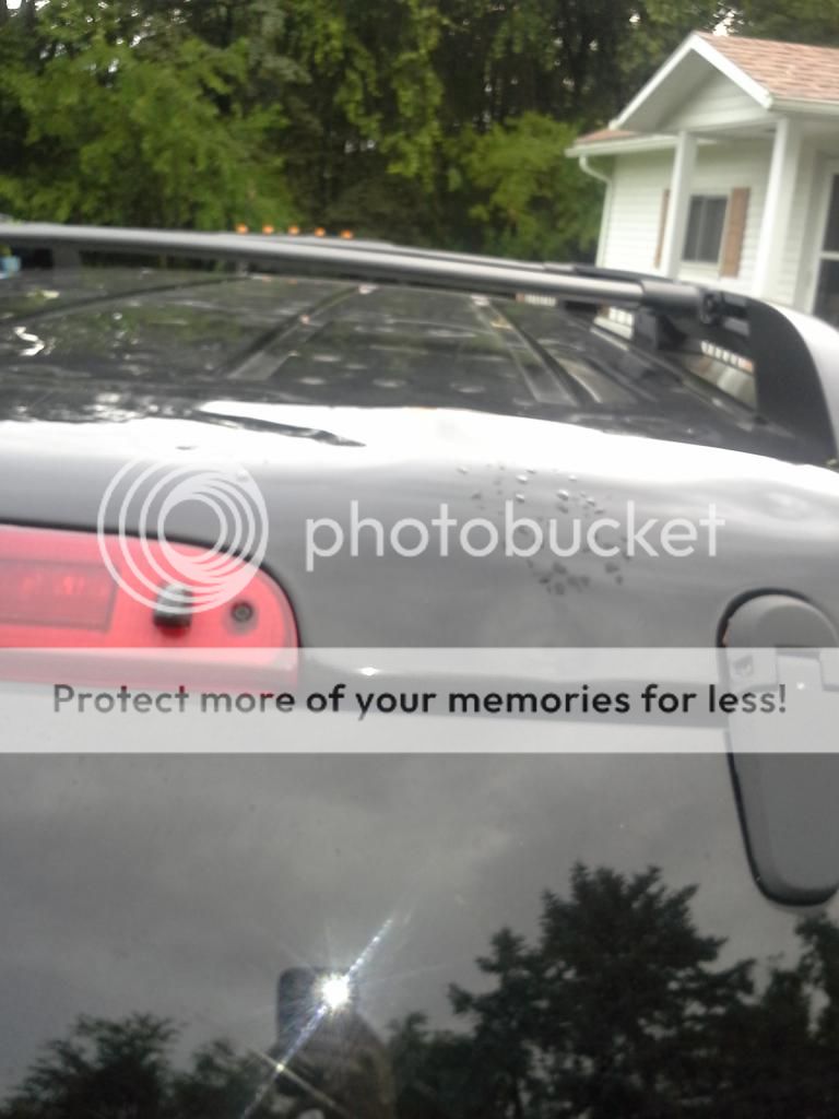

Here is where hail pushed the lift gate UP, that's been fixed already.

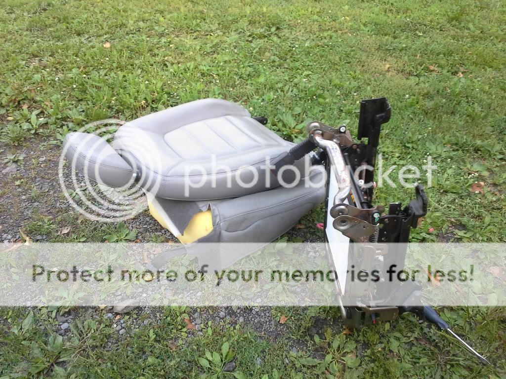

Seats:
I hate leather seats. Hate them.

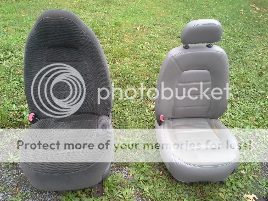

So worn leather out, much better condition cloth in.
Turns out 02 Explorer seats are not plug and play in an 05. Had to do some.... surgery, yeah, we'll go with "surgery"
I had to swap the seat back, lower cushion, and covers from the 02 seat onto the 05 bottom frame because all the plugs, for the air bag stuff, and the seat motors, were different. I wasn't able to save the power lumbar adjust because the way the adjusters attach to the frame is different. So it's manual now.

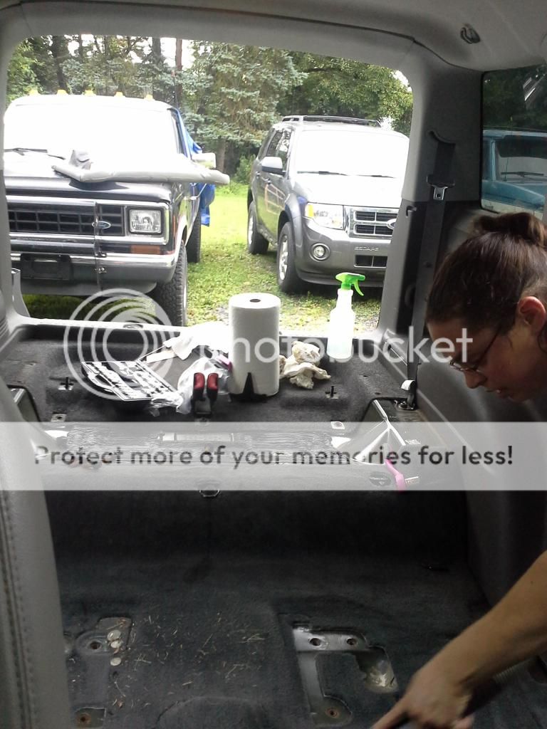

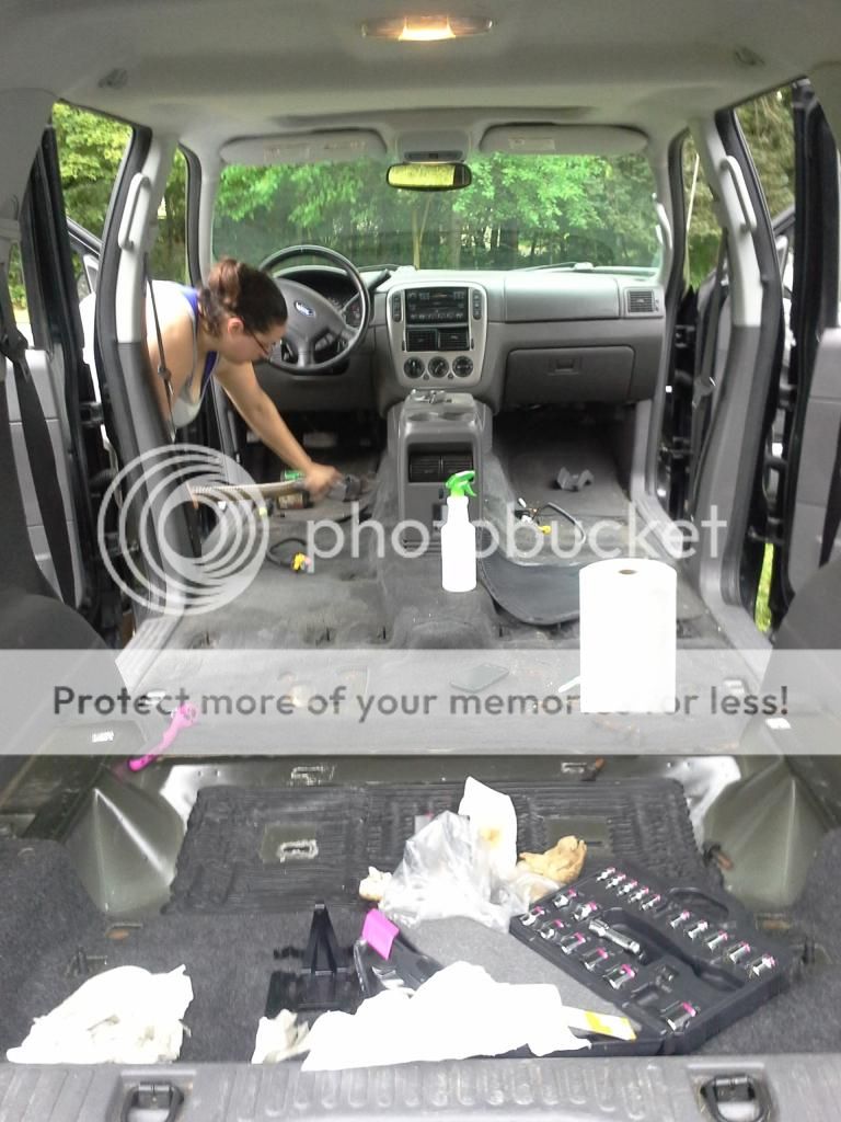

For anyone who has ever wondered, this is what an Explorer looks like with no seats.
Took the opportunity to clean her up real good
The hail that dinged up the right side of the body also took out the right rear window, and sent glass everywhere. Taking the seats out was the only way to get all of it.

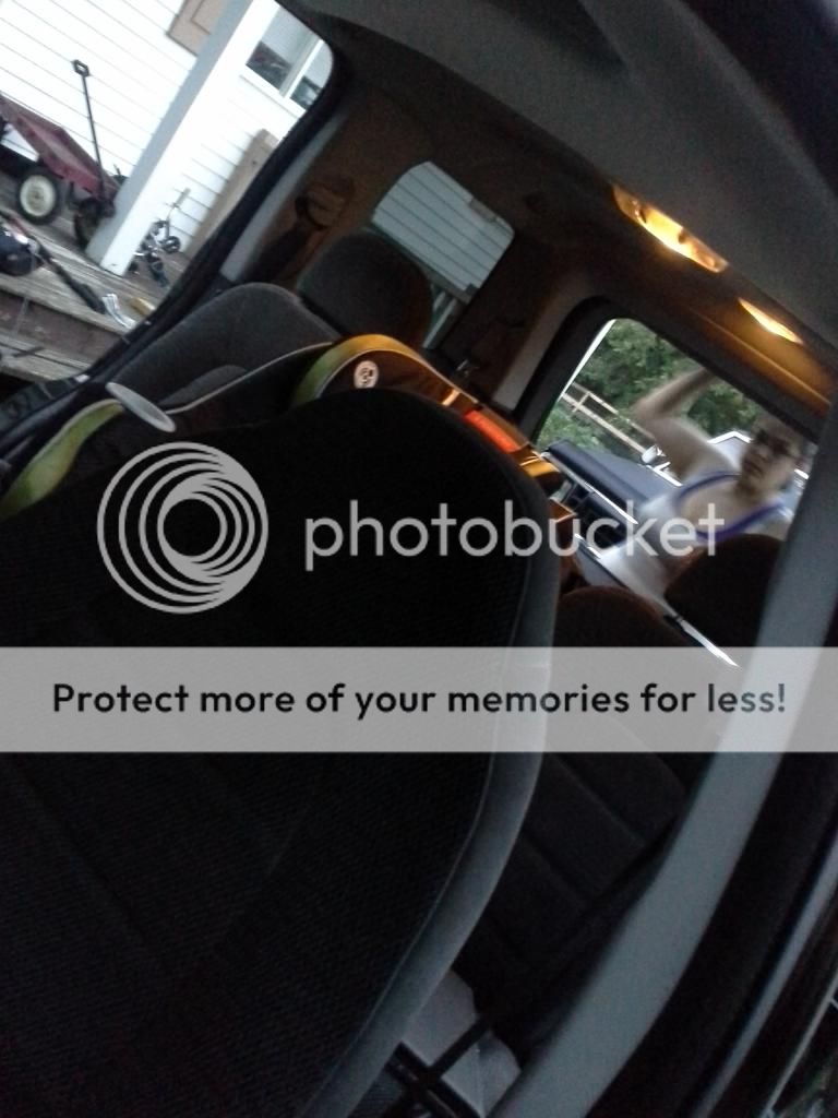

And here is the dimly light end result, got it all in just as we were loosing the light.
The front passenger seat was much easier to convert than the driver's seat. It's all manual, so i just had to swap the seat belt buckle/pretensioner to get the right plugs.

I can't tell from the pics, what's wrong with the hood?

The hood and roof took the brunt of the hail because they are horizontal surfaces. The roof no one cares about because you can't see it, but the hood looks like a golf ball, and it's aluminum, so the dents can't be pulled and have it look right again.
Plus it will probably be less than the cost of dent pulling to buy a used hood and get it painted.

What's your issue with [p]leather seats exactly? They get hot in hot weather? Cloth seats get dirtier/are harder to clean and also tend to have cigarette burn marks when we're talking used vehicles.
They get hot and don't breath in hot weather, they are colder longer in cold weather and we don't have seat heaters, the leather cracks and wears faster than cloth, and it's far more expensive to replace when they wear out.
I have access to professional interior cleaners than mean all I have to do to get the dirt out is spray and run a brush over it. Yes they are more likely to have burn marks on used cars, but I generally don't take interior parts from smoker cars anyway because the smell makes me want to puke.
