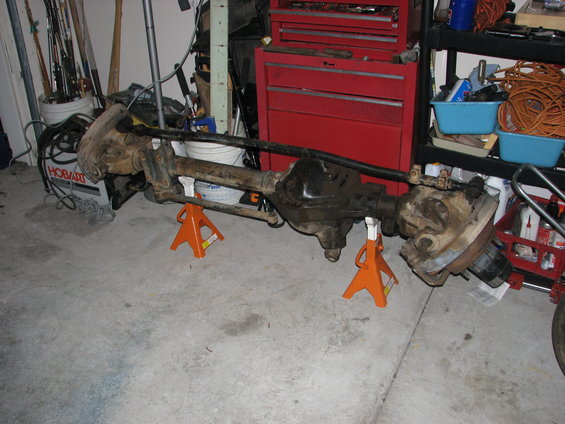

Here are some pics of 79 ford dana 60 fronts.
pics of the axle installed.
I also have a 79 d60 in my 74 bronco.
pic of stock factory 79 front hub
pics of aftermarket hubs for D60

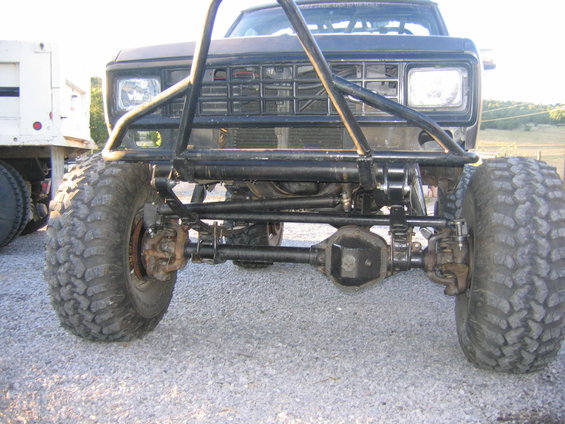

1995 D60
1. Its a ball joint 60
2. Its has calipers/Knuckles specific to 94+ D60's. The Knuckles are different then the earlier ball joint 60's
These calipers are about impossible to grind to clear 15" rims with any more then 2.5" back spacing. I had to run a reverse mount rim with 2" Back spacing and still had to grind calipers to clear.
I had to remove 1.5" off the drivers side housing to gain clearance on the tube for the wedges. The 80's+ Ford 60's have a much smaller Left side shaft which makes for less room on that side of the tube.
the reverse mount rims, I welded a set of D44 wedges I removed from a 77 f150 housing and grinded them to fit the 60 tubes.

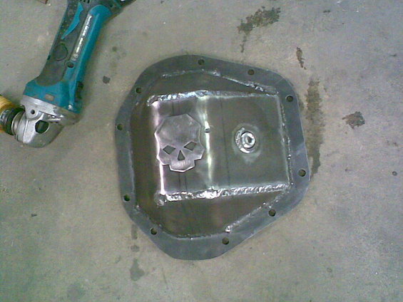

Here is a SRW 14 bolt (prior to 1988) that has been shaved 1.75"s ( the housing is upside down in the pic)
And bolted under with a modified Ruff Stuff diff cover

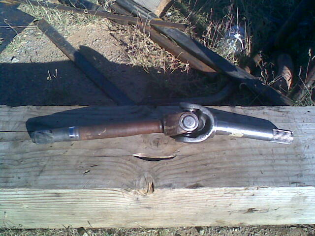

97 F350 PSD Dana60:

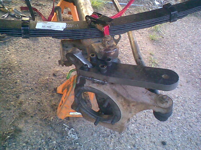

Home made hi-steer arms on the balljoint knuckles:
35spline pr0n:
Ballistic Covers:
Complete (minus front through bolt on hi-steer arms to lo steer arms):

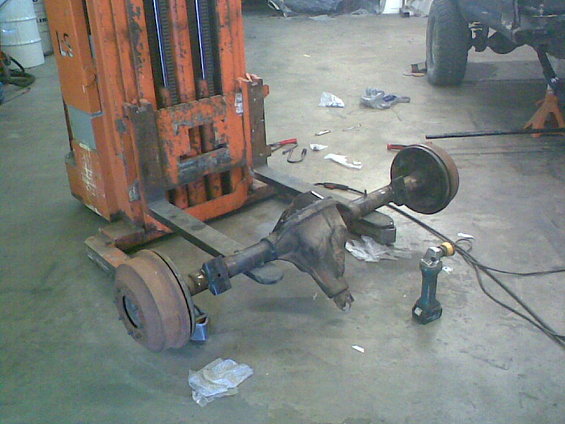

Rear Semi-Float Dana60 from 84 F250. 35spline shafts:
Edit: I also run 15" rims, Grinding was easy w/ 2.5" BS rims.
