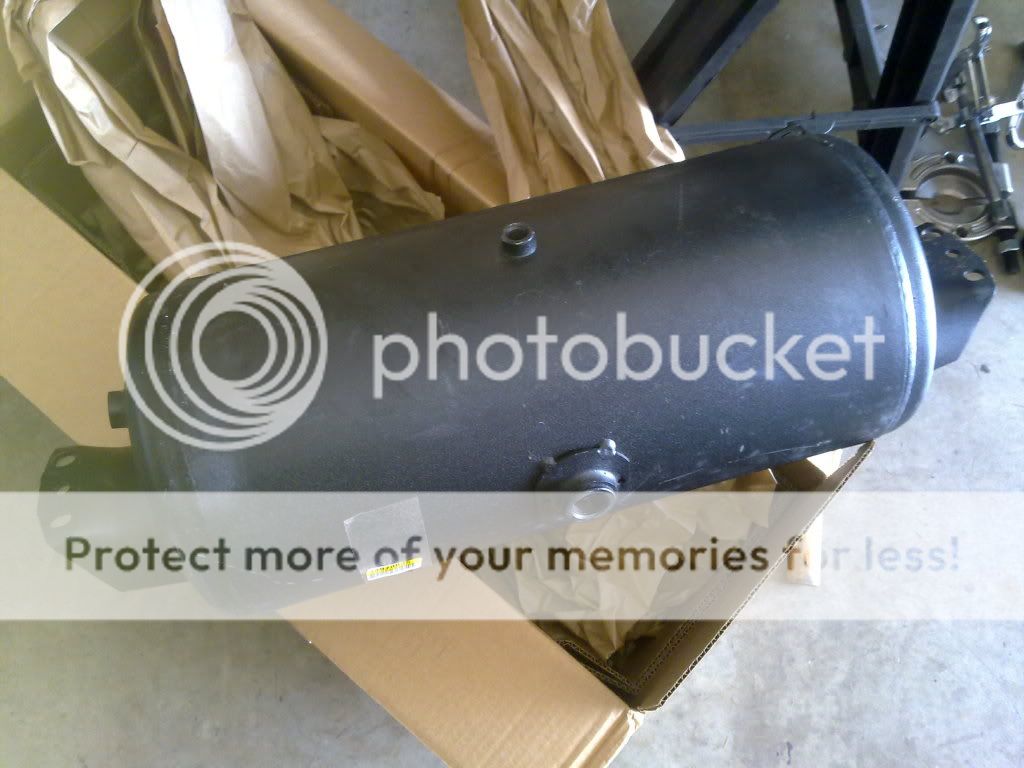

Here is the tank I used. It's for a semi tractor.
I mounted it under the bed behind the axle where the spare tire was.
Had to weld brackets to the frame, was a little smaller than the frame width.

Nice:icon_thumby: The tank looks really close to the shocks but I take it you have not had any clearance issues since you been running it for awhile. Also does the tank have a drain petcock for condensate?

Forgot to mention that, but yes it does have a drain valve.
There is plenty of room for the shocks. It might look close in the picture bit its not.
