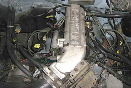

I have a question about (motor) timing I was hoping to get some assistance on...
It's running pretty fat right now from the smells of it and I don't wanna smoke my brand new catalytic converter or foul the sexy new plugs. With that being said and the fact that I'm at sea level and using standard (89 octane) I wanted people's opinion on advancing the timing to 12 degrees BTDC as I saw recommended here on the Bronco Corral:
I know 10 degrees is standard and I'm not sure if bumping it to 12 degrees isn't a bad idea...? NOT looking for more power, just as lean/clean as possible.

Guess you could try it and see what happens. Smell test isn't real accurate, what "smells" rich might be perfect if you use a sniffer to sample exhaust gas... or not, there are a million variables that could affect air/fuel ratio. If there is another issue causing a rich condition, adjusting the timing won't do much.
I don't know why that page suggests running 89 octane. These are not super high compression engines. I run 87 in mine all the time, I even ran 85 when I could get it. It never pings or runs weird. I am at 3200', maybe at sea level things are different for you but I don't feel that high octane fuel is a benefit.
Speaking of catalytic converters keep in mind that you're running 1980's tech here, even if the parts are new. Cats had only existed for about 15 years in 1988 and they weren't even mandatory on everything - modern converters are WAY better at removing odors than the old ones were, even if both were functioning perfectly.

@Shran that article I linked where it's suggested to advance the timing to 12 degrees stated to do so with a 180-degree thermostat and 89 octane. Since it gets CRAZY hot here I'm gonna stick to 10-degrees out of an abundance of caution...
